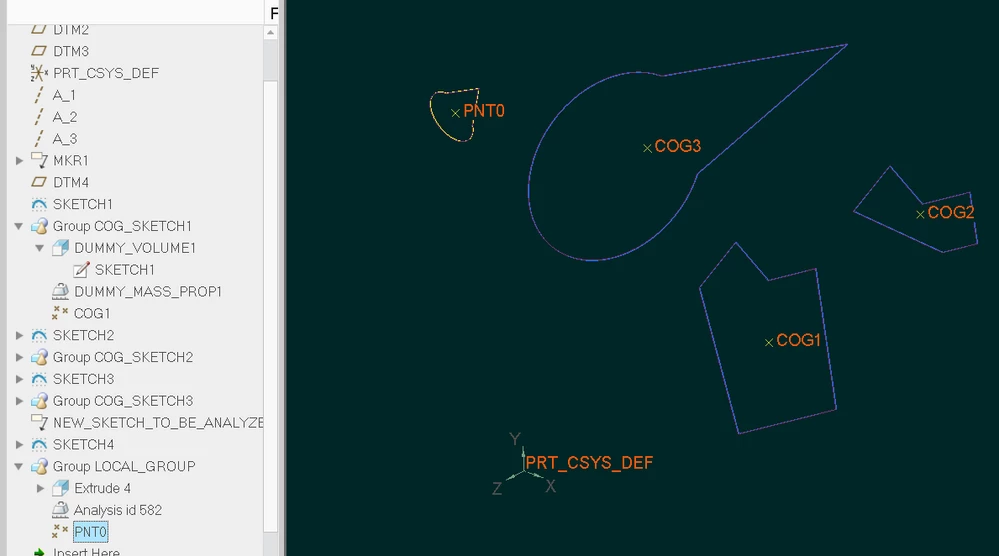

One "improvement" I can think of is to use mass properties analysis feature:

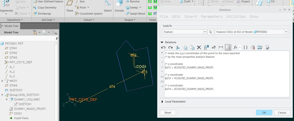

and apply this analysis to symmetrically extruded and capped quilt to obtain the X,Y,Z coordinates of its COG:
In this example, in generally similar way that you show in the video, I generate point representation of the COG of SKETCH1.  The relations are inside the point COG1 (offset-coordinate-system type) and use the parameters from the mass properties analysis feature DUMMY_MASS_PROP1 - which is applied to the quilt DUMMY_VOLUME1.

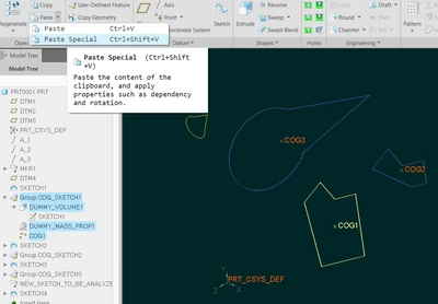

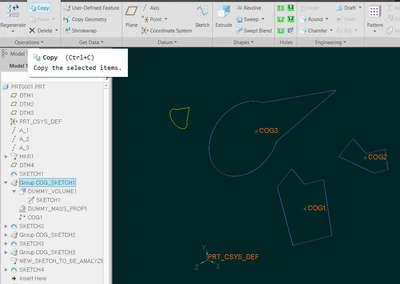

Last thing I'd like to mention is that you can then turn this into an UDF or use the copy and paste-special (+advanced reference configuration) functions to easily generate the COGs for other sketch sections in your part model:

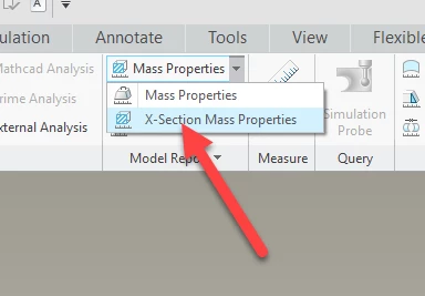

You can get x-section CGs using x-section mass properties. Then you can use those coordinates to get your points.
Is that where you are going or Am I completely out in left field?
Screen shot is Creo 4.
