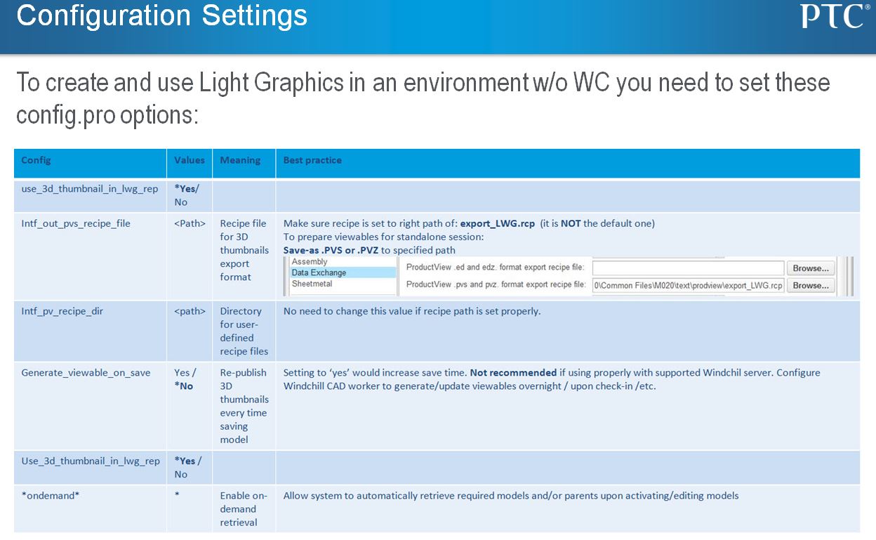

See the image below to set up the config.pro.
you must also have the file LWGthumb.rcp for publish the thumbnails into your Creo Data Exchange session. see the image below. This file is already set for usage.
The rcp file is installed here :
for example X for your disk:\\install_path\Common Files\M070\apps\prodview\recipe
