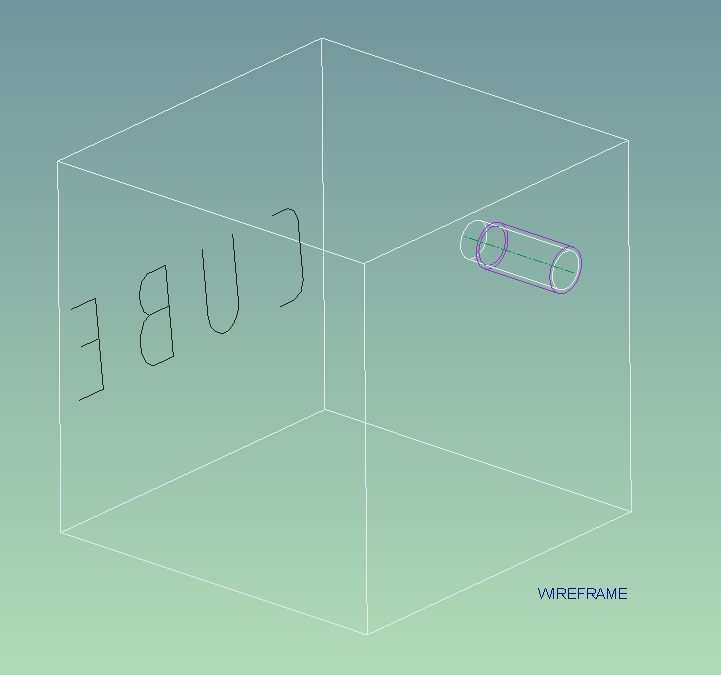

Environment: Creo 3.0, part or assembly, No Hidden display style
I have a part that I have written text on using a sketch and that sketch can be seen no matter the orientation of the part in any of the hidden line modes. See Capture.png, text should not be visible from that angle.
I know I can just hide the sketch but this becomes problematic in an assembly with many items with many sketches. Besides I really dont want to hide the sketch because it represents marking on the item that's really there.

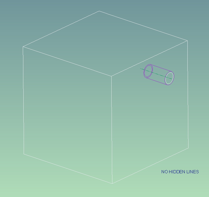

I have found that if I turn Fast HRL off then the sketches hide properly but then all the cosmetic threads show up. See Capture2.png, thread should not be visible from that angle.
I might be able to get around this if I were to make a drawing of the assembly, but this to becomes problematic when I need many images in different orientations.
All I want is a real No Hidden line view for illustrations.
