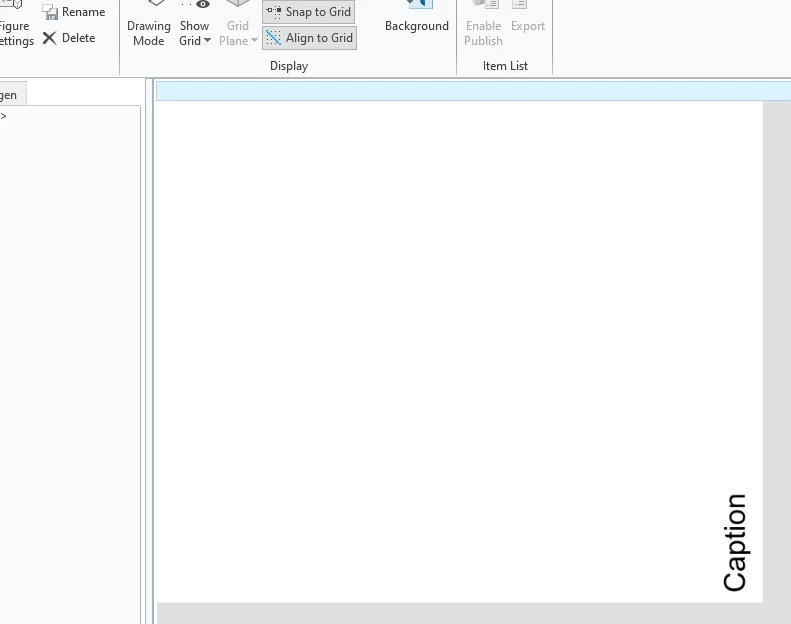

Hello Community
It is our industries requierement to add a caption to each illustration, to give information about projekt number etc.

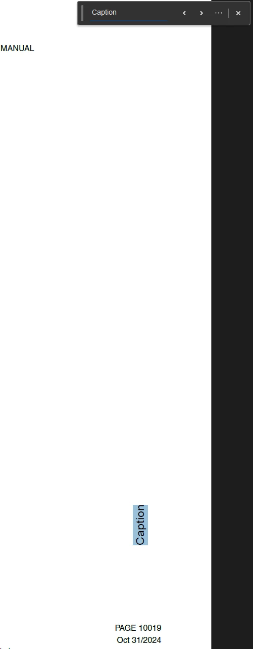

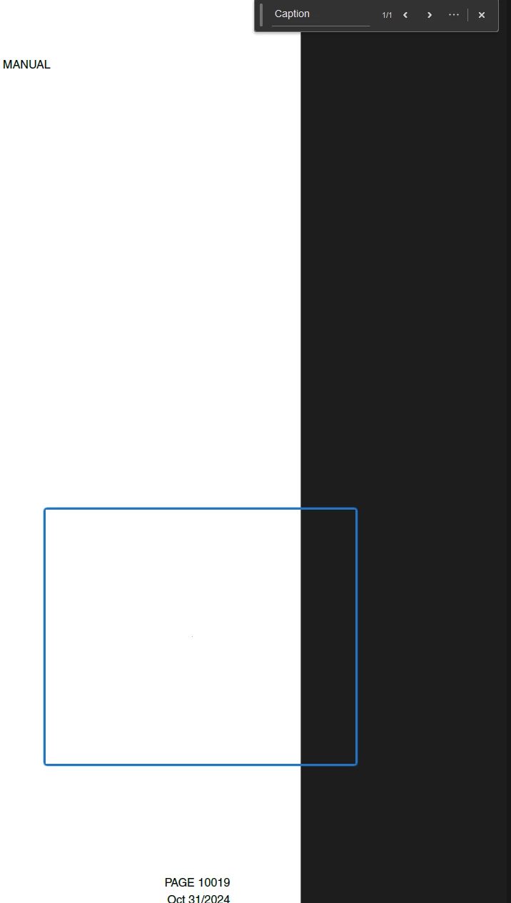

This caption is invisible when the CGM files are published as PDF (screenshot: "pdf from illustrate", compare to screenshot: "cgm in illustrate").
The text of the caption can be found and located through the search function in the PDF but it can not be made visible.
My workaround is to create the files in Creo Illustrate and save them as CGM - then open them in Isodraw only to save them as CGM again.
With this extra step the caption stays visible in the PDF (screenshot: "pdf from isodraw").
It seems that Creo Illustrate marks the Caption as metadata, so that is not to meant to be seen.

Can you clarify what figure type you are publishing from 3D or 2D?
From your screenshots it looks like a 2D figure.
8-Gravel
December 16, 2024
Hello Agarland
You are correct, I publish from 2D.
December 16, 2024
I am unable to reproduce the issue here, when I publish to PDF from a 2D figure in illustrate I can still see the caption.
I would recommend contacting tech support to log a case so this can be investigated properly.
