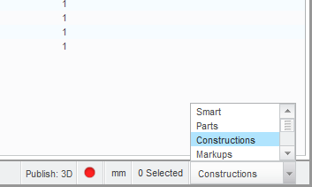

In Creo Illustrate 3.0 M020, I unexpectedly get the following mouse pointer in the Figure Viewing Area:
I dont know how I got it, but with this pointer visible, transforming parts/assemblies seems no longer possible.
Any idea how I can get back the normal Selection mouse pointer? And does anyone know what the function is behind the mouse pointer above and how to use it?
Thanks in advance.
May 28, 2014
Yes, you've clicked on a selection filter found in the right hand side of the status bar:
Changing it back to 'Smart' will allow you to transform part again.
