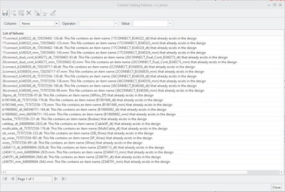

I have converted the Creo Schematics Lite to Creo Schematics Full version.
This works well until I want to link an old design to the catalog.
I get the following report and can't solve it.
Who can help me solve this?
By the way the items that are mentioned are not fysical on the design.
I workes in the past with the central Library and a Template.
Best answer by NC_4023452
I tried it but it's not solved.
I tried to delete the Datadables and then it fixed the error but when I import them again it doesn't work. He lost his dataset.

These are Datatables and Member maps. One thing to try, is to disconnect from the catalog and then reconnect the catalog and see if that will resolve these. I have found some occasions this will resolve on its own.
