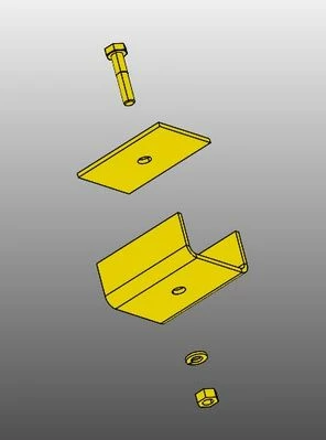

Creo View Offset Lines
  • April 28, 2022
  • 2502 views

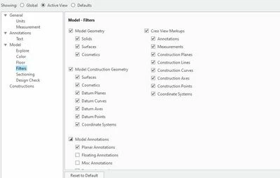

Is there a way to show offset lines in exploded views in Creo View 5.1?  The Exploded view seems to publish fine, but the offset lines do not show up even when all construction geometry features are checked in the config settings (see below).
Best answer by vdegaonkar
The functionality needs Enhancement in Creo View Adapter & Creo Parametric. Work is under construction and soon functional compatibility will be defined.
May 3, 2022
December 13, 2023
Is this function available now? I can't show my offset lines on the PVZ
