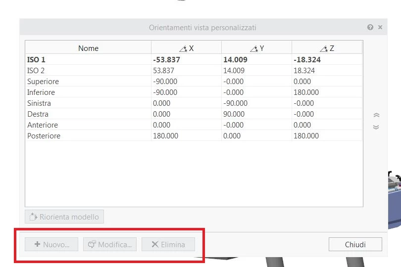

I can't add a new oriented view.
The button is disabled.
Why ?

Hello @AR_01
What version of Creo View are you using?  The ability to create new standard orientations is only possible through Creo View MCAD.
Once you've created them however, you can still use them even if you've launched Creo View Lite.
Hope that helps.
June 8, 2023
Actually , the Creo Viewer Express do not support this operation,
you should upgrade you viewer or just set it by coding
