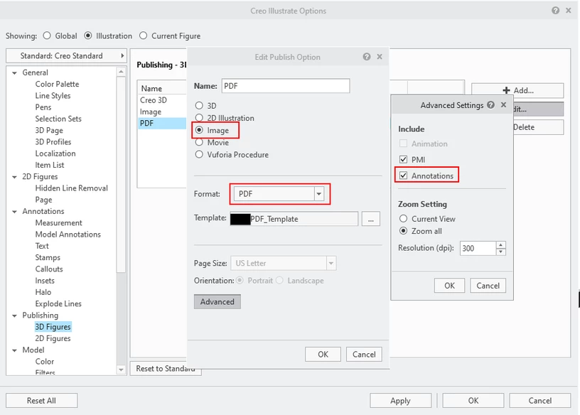

I would like to display the sequence step description on the published PDF.
There is no setting to configure it in the PDF template:
https://support.ptc.com/help/creo/illustrate/r10.0/en/#page/creo_illustrate/install_config_guide/Formatting_PDF_Publishing.html#
Is there some workaround or hidden attribute to enable it?

September 6, 2024
I take it these are 3D PDFs you are publishing?
Currently the step descriptions do not get included when publishing to 3D PDF, this would be a good candidate for an Product Idea.
Creo View / Illustrate / Schematics Ideas - PTC Community
The step descriptions are included in image based PDFs however.

Hi Agarland
I changed it to Image PDF and it doesn't work either (settings in picture below). It does work if I select PNG, but then I have to put the images into another tool for the formatting.
When creating Step by Step instructions with Creo Illustrate, what is the workflow to have an instruction with pictures and text? Do I need Arbortext?

September 6, 2024
Hi Alex,
I overlooked the fact you were using a PDF template and it looks like the step description does not get included when using a template. This would certainly be a good candidate for a product idea, to include the descriptions when using a template.
Using Arbortext would certainly give you a much more comprehensive solution but I can't comment on the details of what you can and can't do I'm afraid.
Maybe somebody else on the forum can comment with some guidance on Arbortext.
