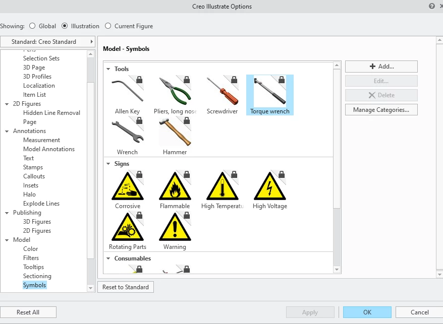

Is there a way to unlock the symbols in the symbol library and edit the text description?

Hello MH,
I have just tried it out. It should work with the Creo Illustrate Administration Tool.
I would also recommend creating your own "Standard" with the Creo Illustrate Administration Tool.
