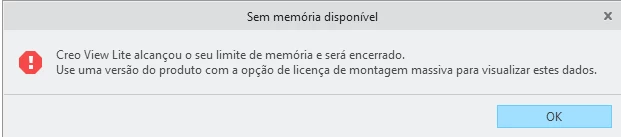

Hello, I have an error in creo view, when I open it. As it is in Portuguese.
creo view lite has reached its memory limit and sewra has closed use a product version with the massive mount license option to view this data .
We did the tests on another machine and it was normal, I already removed the program, I restarted the machine and nothing

Hi @MS_Santos
Now, you could solve this with Creo View 11, because it Increase memory limit for Creo View Lite and Express from 4gb to 16gb.
Look at this thread
