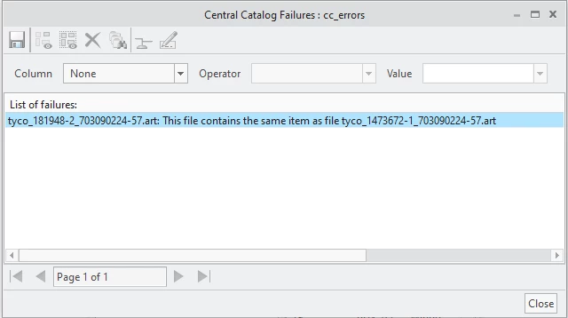

Regeneration is not happened properly in Creo schematic and i get the Error " Error Occured While loading the Catalog". Reference snap attached. Please suggest to fix the issue
April 18, 2023
With reference to the above, I've added one more snap "Cental Catalog Failures: CC_Error".
June 9, 2023
When I have seen this, first go to this offending item in the internal catalog and rename it. In case your not aware Schematics has a internal design catalog and then there is option to set up a Central catalog. If there is one in the internal design that has the same name that one has in the central catalog, then you will need to rename the one in the internal design.
