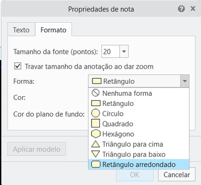

I need to create a note with a symbol similar to a drop, in the notes menu there are only square, triangle, ellipse...
I would like to know if there is a way to customize these shapes?
Best answer by vdegaonkar
Not really, Creo View provide predefined shapes.
If you are looking for additional shape - requesting to create a Product idea with details like what type of shape, usage etc
May 30, 2025
