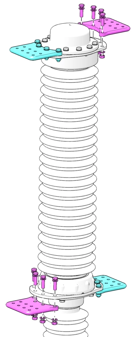

1.) Is it possible to create a kind of interrupted or collapsed view (or what I shou call it) to push large parts together (example: View1 and View2)?

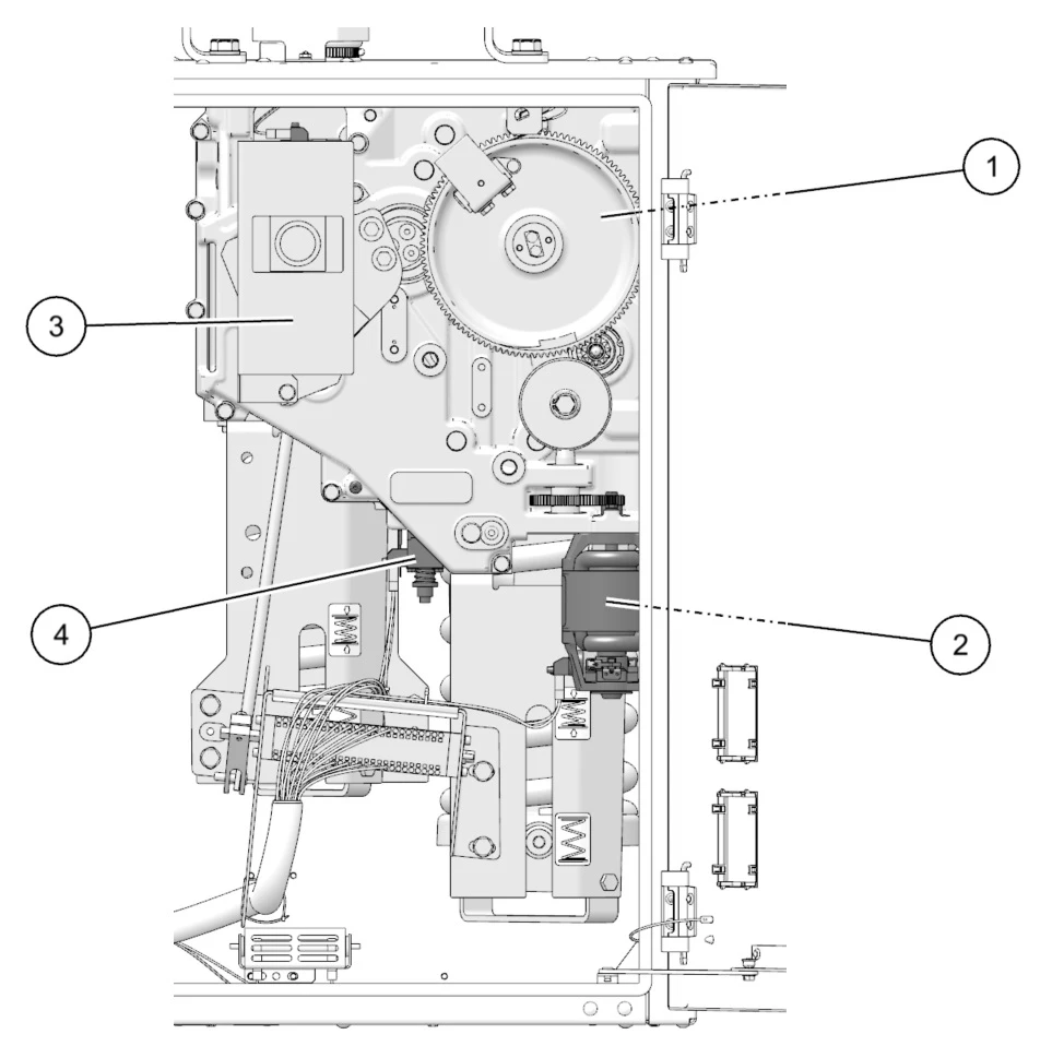

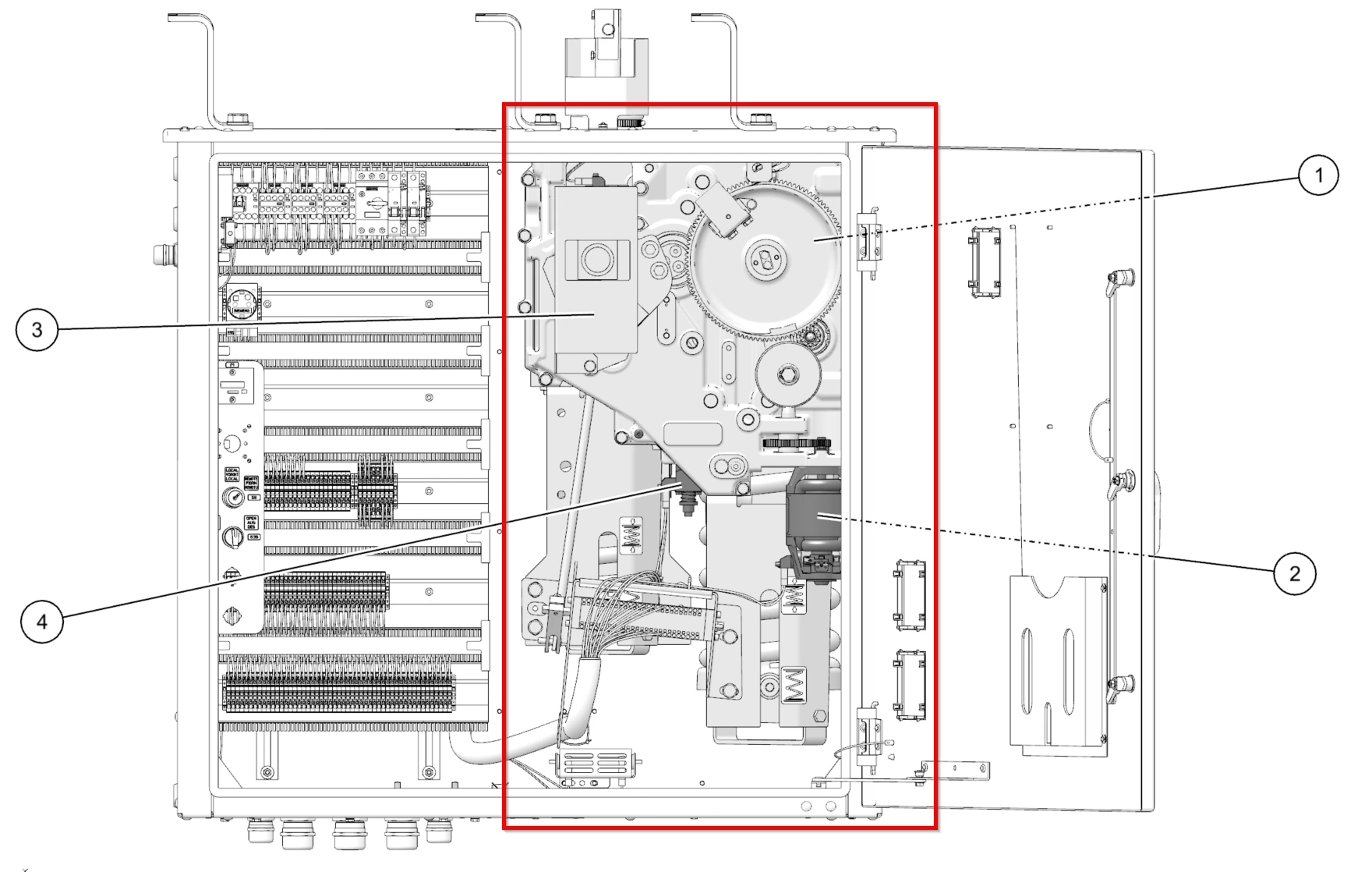

2.) Is it possible to display only a part of a view, so that it is still possible to place position numbers (callouts) on the left and right (example: View3 and View4)?
Thanks and greetings

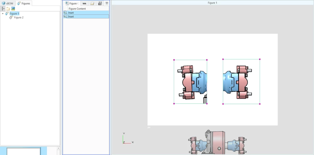

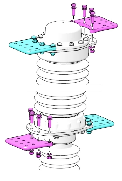

So there is a way to create a figure that is very close to what you are looking for using the insets and a 2D figure.
Here's the basic steps:
  1. Create a 3D figure showing the assembly in the correct orientation
  2. Add two insets that contain the details of each end of the assembly (See image 1 below)
  3. Turn off the borders for both insets
  4. Move the main view of the assembly outside the page (again see image 1)
  5. Now create a 2D figure from this 3D figure
  6. Hide the two inset views and select/delete the unwanted main view
  7. Unhide the insets and manually add the curved lines to indicate the truncated view (Image 2 shows a very rough example)
Hopefully that gives you enough detail to get the view you are looking for.
