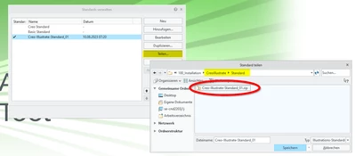

Hello all,
we´re trying to find a smooth way to share and update an illustrate standard maintained via the Administration tool to several users.
Is there a nice (and possibly native) way how to do?
I can also imagine something within sharing the standard via Windchill
Question is related to Illustrate 9 &10
Similar question was already raised here , but not about the sharing / updating of an standard
October 18, 2023
Hello mzerle,
we handle it in such a way that we share our self-defined standard via a central fileshare folder.
When I have changed (updated) the standard, I place it in our defined folder using the "Share" function of the admin-tool (see picture below).
Then I inform the colleagues about the updated standard. It is up to the colleagues to decide when to integrate the new standard in their CI.
