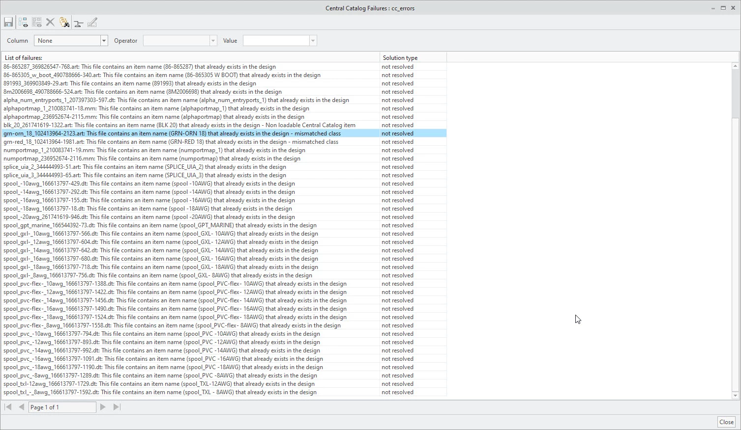

When i set up my old design to call the central catalog i get a bunch of errors wanting to rename datatables.  I would rather them use the datatables from the central catalog.   How can this be avoided?   Ive updated the datatables manually in the design to what i put in the central catalog but i still see that it's throwing an error as a duplicate.  I would like a streamlined import.   are there other toggles i can do to streamline the datatables.
If we are forced to rename them can PTC give us a way to rename them all quickly with a formula (similar to renaming in a Creo assy)

I'm assuming your old design was NOT created using any central catalog. At some point you switched from a standalone template (the entire library being contained within each design) to using a Central Catalog. Is that right?

Yup! you guessed it!  it was a pre-central catalog design!
April 29, 2024
Anyone have a best practices here?   ive got some really old RSD designs that need to be migrated and id rather not duplicate datatables and blocks if i can help it.
