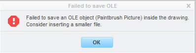

! failed to save an OLE object (Painbrush picture)
I am trying to insert an object onto my Creo drawing and get the above warning.
In todays world a 8MP file is common and reducing the file will reduce clarity.
My question is what is the largest file CREO can handle?

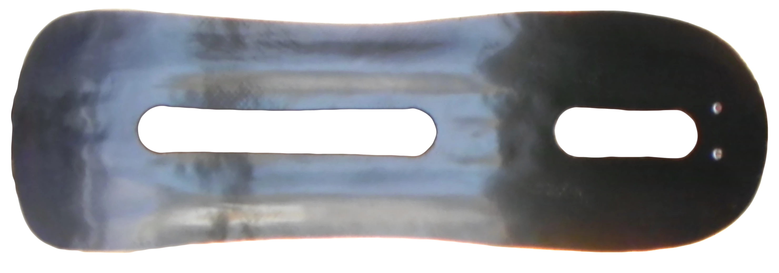

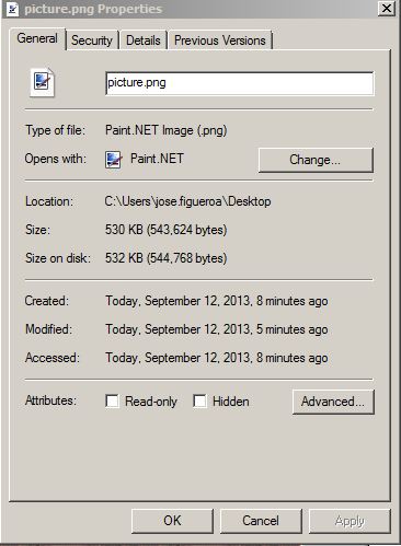

part.JPGUsing the following method.....
Insert -> Object -> paintbrush picture -> then cutting and pasting my file....
The largest file I have been able to paste is 500K!

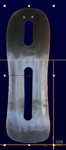

I can import a 1.5mb PNG file without issue. See attached.

Trust me, that is the drawing file. The note on the bottom just says what part is active in the drawing. See the SHEET 1 stuff?
Sep 12, 2013 11:54 PM UTC
For the sake of completeness, I took the bitmap image up to nearly 8 megs. The imported image and the drawing size have little to do with each other. In this case, a D-size drawing and an 11x17 120DPI color image (I know, it only has two colors!) is twice the size of the drawing. In case the drawing is only 11x17, again, the image was twice the size of the drawing. Go figure. I also find it difficult to maintain the aspect ratio when you have to resize these.
Regardless, I was able to import the 7.8mb image and save the drawing file.
