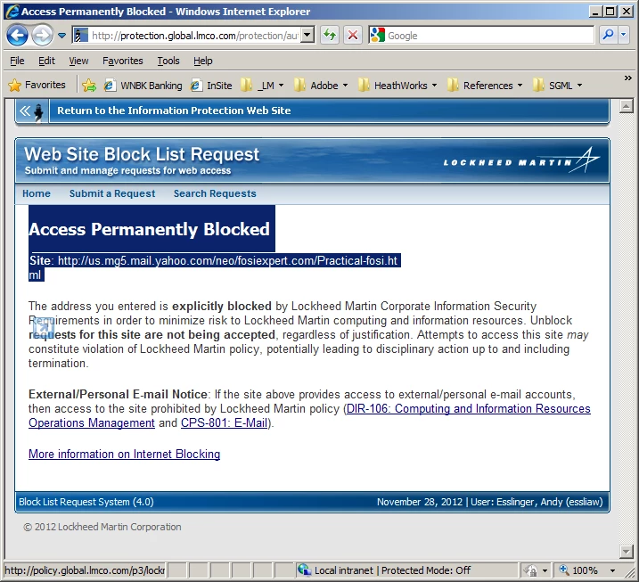

    Nov 28, 2012 8:17 PM UTC
    Looks like the fosiexpert site moved to a Lockheed permanently blocked address.
    [cid:image003.jpg@01CDCD6A.AAE4EF10]
    \ / Andy Esslinger LM Aero – Tech Order Data
    ______-/\-______ (817) 279-0442 1 Lockheed Blvd, MZ 4285
    \_\/_/ (817) 777-3047 Fort Worth, TX 76108-3916
    Nov 28, 2012 8:22 PM UTC
    Andy,
    Don’t feel the like the Lone Ranger. Boeing has the same block on it.
