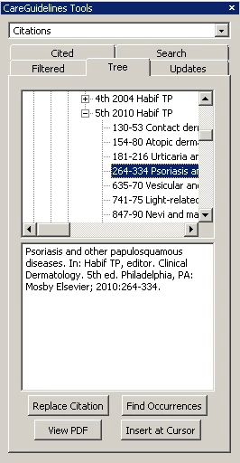

    Typically, to manage this type of content insertion, we have a custom XUI
    toolset that sits to the left of the Editor window. This allows for
    selection of database objects, with the ability to "Insert at Cursor"
    [image: Inline image 3]
    This is an example of citation insert, where clicking "Insert at Cursor"
    puts in tag content, in this case <citation db_id="12345"/">. We have
    some FOSI rules that display correct numbering, and when moused over, we
    display the citation text (sourced by its db_id) in the tool pane.
    > While I could probably do the same type of thing with a mouseover, it
    > would
    > be nicer for graphics to have them displayed inline as mentioned in the
    > screenshot above.
