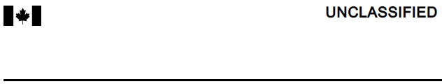

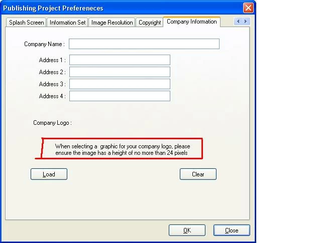

Does anyone know what the pixel dimensions are (L x W) for a Logotype in
the header of an S1000D document? I took a look in the spec but it
doesn't seem to mention it anywhere apart from a vague reference to a 32
mm or 50 mm width in the header, Chap 6.2.1. Graphics can apparently be
a minimum of 300 dpi.
Greg
J
    6 replies
    Apr 7, 2011 6:58 PM UTC
    Hi All,

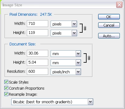

    I guess I'm not patient. After some trial and error I scoped this out.
    The logotype has to be 710 pixels wide by 110 pixels high. Although all
    I want is a flag, to make it proportional, it occupies only a part of
    the total image area.
    Greg

    Hello Greg,
    You are unlucky - max height size of logo in pixels is 24 pixels (look
    attached slide). Ma? width of logo can be 30mm max, it does not satisfy to
    ASD standart which requires 50mm in width. I created a call to PTC with
    request and even SPR
    <">https://www.ptc.com/appserver/cs/view/spr.jsp?n=1969288> 1969288 has been

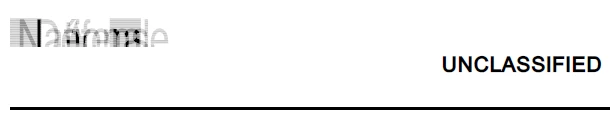

    Hi Alexander,

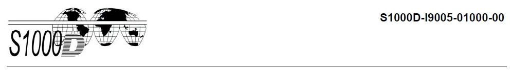

    I noticed that too, I thought, ok, I can do that. However, like you I noticed that a logo which is 24 pixels high doesn't seem adequate for most uses or agree with the spec. The S1000D specification gives examples of a couple of different widths and the page header is 15 to 17 mm high and the logo can be between 32 and 50 mm wide, Chap 6.2.1 figures 6, 7, and 8. I make a potential logos to be 50 x 17 mm (142 x 48 pixels), or 50 x 15 mm (142 x 43 pixels), or 32 x 15 mm (91 x 43 pixels). Graphics in S1000D are also to be a minimum of 300 DPI according to the spec.
    I thought my 24 pixel high graphic didn't quite look right. It looked stretched to fit and distorted.
    So, I did find another way of working with a logo in the markup of a Data Module but initially I ran into trouble figuring out what size it should be hence my previous post. In the markup of each Data Module I found you can specify a logo after security:
    <dmstatus issuetype="new">
    <security securityclassification="01"/">
    <logo>
    <symbol id="ACQDS-IDAR3TTE" infoentityident="ICN-PLUTO-A-000000-A-00000-00066-A-01-1"/">
    </logo>
    I tried a couple of things using the markup, but I had the same problem as with my 24 pixel logo. The logo gets stretched to fit within a defined space, and since it had some text, it got pretty ugly:
    I noticed that the S1000D logo as printed in the spec is fairly large, approximately 42 x 15 mm, and it looks decent, it seems at odds with the 24 pixel definition.
    I exported the page of the PDF to jpeg and measured the output of one of my distorted logos in Photoshop. I noticed it was 60.11 x 9.31 mm, 710 x 110 pixels. So I think the logo has to fit a particular size. If I want my flag to appear it has to be left justified in the "white space" , please see my "test_logo.jpg" attachment which is a mock up. After the test I got a reasonably good flag logo in my PDF output.
    However, I have yet to try the dimensions that the spec say's the logo should actually be. Have you tried this markup?
    Greg

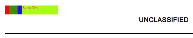

    Apr 11, 2011 3:05 PM UTC
    Here's what the "test_logo,jpg" looks like printed to pdf, I changed the white background to lime green:
    I make it to be:
