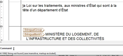

I am using Arbortext 8.3.  Here is the simple function in question:
replace("ʼ", "’", 0x2000);
The user has a file that contains a mix of apostrophes.  We want a consistent character used.  The first apostrophe is the U+02BC : MODIFIER LETTER APOSTROPHE {apostrophe} and the second (the desired one) is U+2019 : RIGHT SINGLE QUOTATION MARK {single comma quotation mark.
Using the following text, the last apostrophe is the one we want swapped.
la Loi sur les traitements, aux ministres d’État qui sont à la tête d’un département dʼÉtat

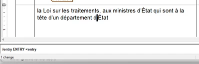

Using the replace function above, if I run from the command line in Arbortext Editor it works perfectly.
However, when I save that one line of code, as its own ApostropheSwap.acl file, and do a "source ApostropheSwap.acl", it does not find a match.
I have tried saving the .acl file as UTF-8 and ANSI, and both get the same result.
Any ideas would be greatly appreciated.
