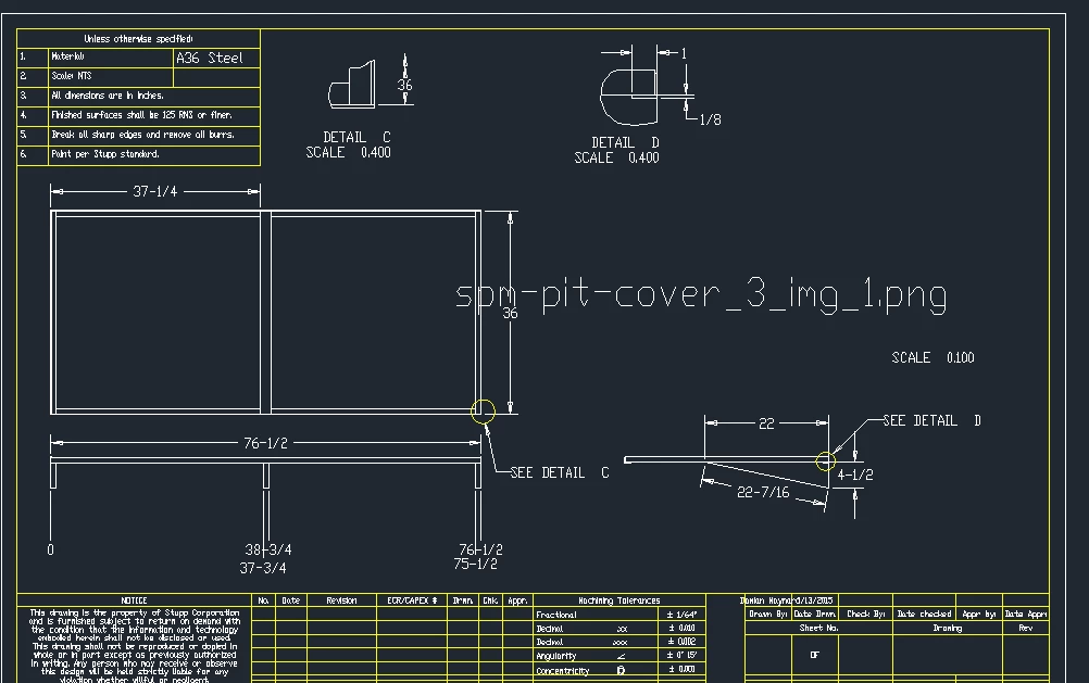

Conversion issues going from .drw to .dwg

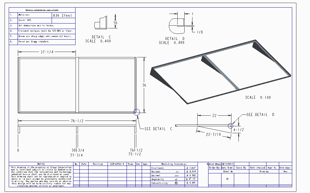

My isometric image is not showing when I convert from a .drw to .dwg. Attached is what I get. Does anybody know why this happens and how to fix it?
dmaynardAnswer
Jan 27, 2015 5:49 PM UTC
Just got off phone with PTC techinal support and here is the answer. AutoCAD does not recognize .png files. To solve this, when you create .dwg files from .drw files, go to the "misc" tab and select ".jpg" to export images as jpegs. To make it a default, go to configuration editor and type in "int2d_out_image_format" and set to ".jpeg" to export all .dwg's as jpeg.

Not much help on the dwg portion - not a new problem http://communities.ptc.com/message/255583#255583
Apparently the shaded image file is also created at the same time, and saved in the same location as the dwg.
Jan 14, 2015 1:25 AM UTC
The only fix is to create an overlay view using a no hidden option. The shaded view is not part of the translation other than to create the image like David said. I think shaded image implementation in Creo, as in WF, was only a half hearted implementation. There are so many limitations it is difficult to defend its use in general practice using Creo.
