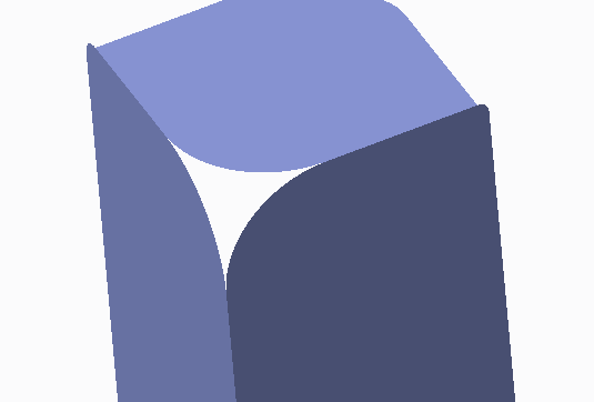

    A different approach might be to use surface copies and vertex rounds to cut back the corners:
    Unfortunately I've never been able to get a patch to work to close it back up. Probably due to the topology as mentioned here: Vertex fillet | SOLIDWORKS Forums

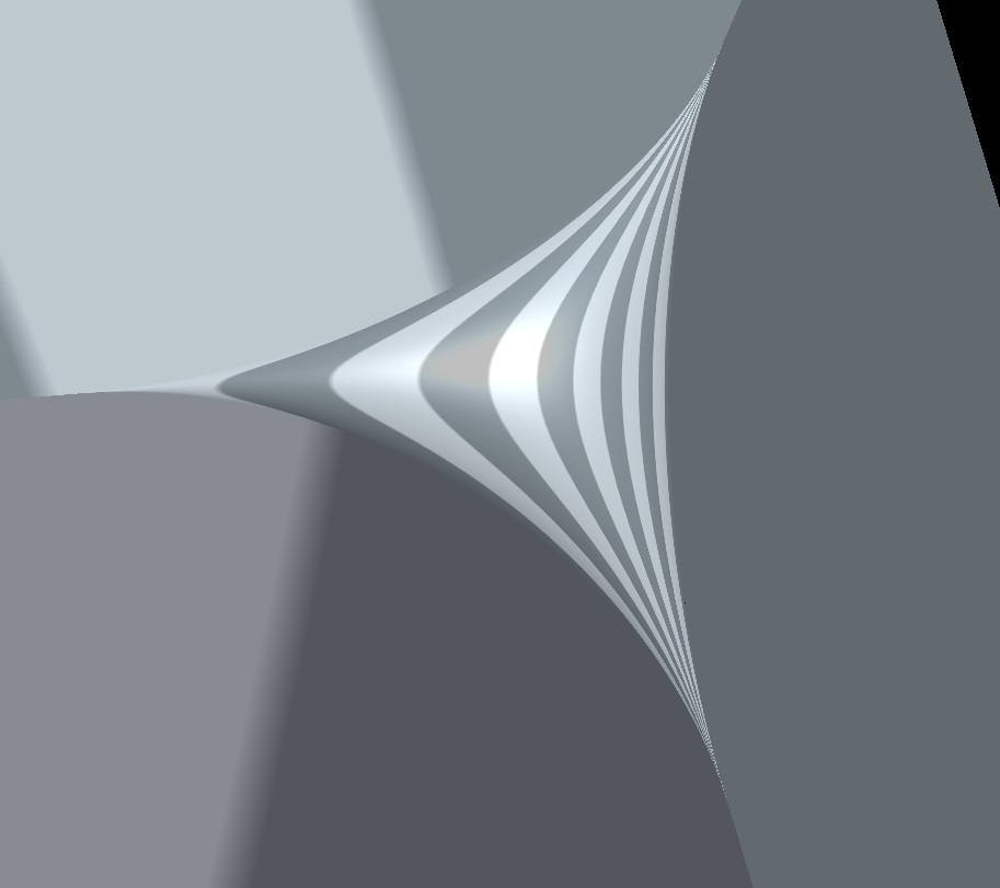

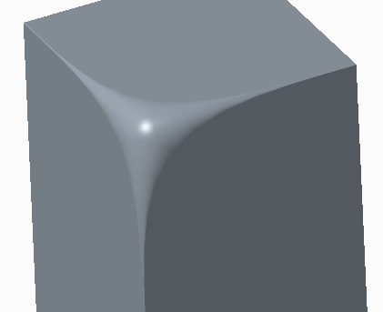

    I can't take credit for this, I ran across the technique here years ago if I remember. The only change I made was using conics for the 2 guide curves and the section curve. I think it smooths things out even a little more (though simple arcs looked fine), plus then you can change the shape of the "radius".
    TomU
    Apr 7, 2015 5:29 PM UTC
    Frank, it really looks nice. Basically the same technique as Antonius, but without the center trajectory. The advantage of your method is that Creo will gladly split it with a plane down the middle. The full circle method didn't allow this.
    I'm still amazed that Creo makes the surface with the arc length going to zero.

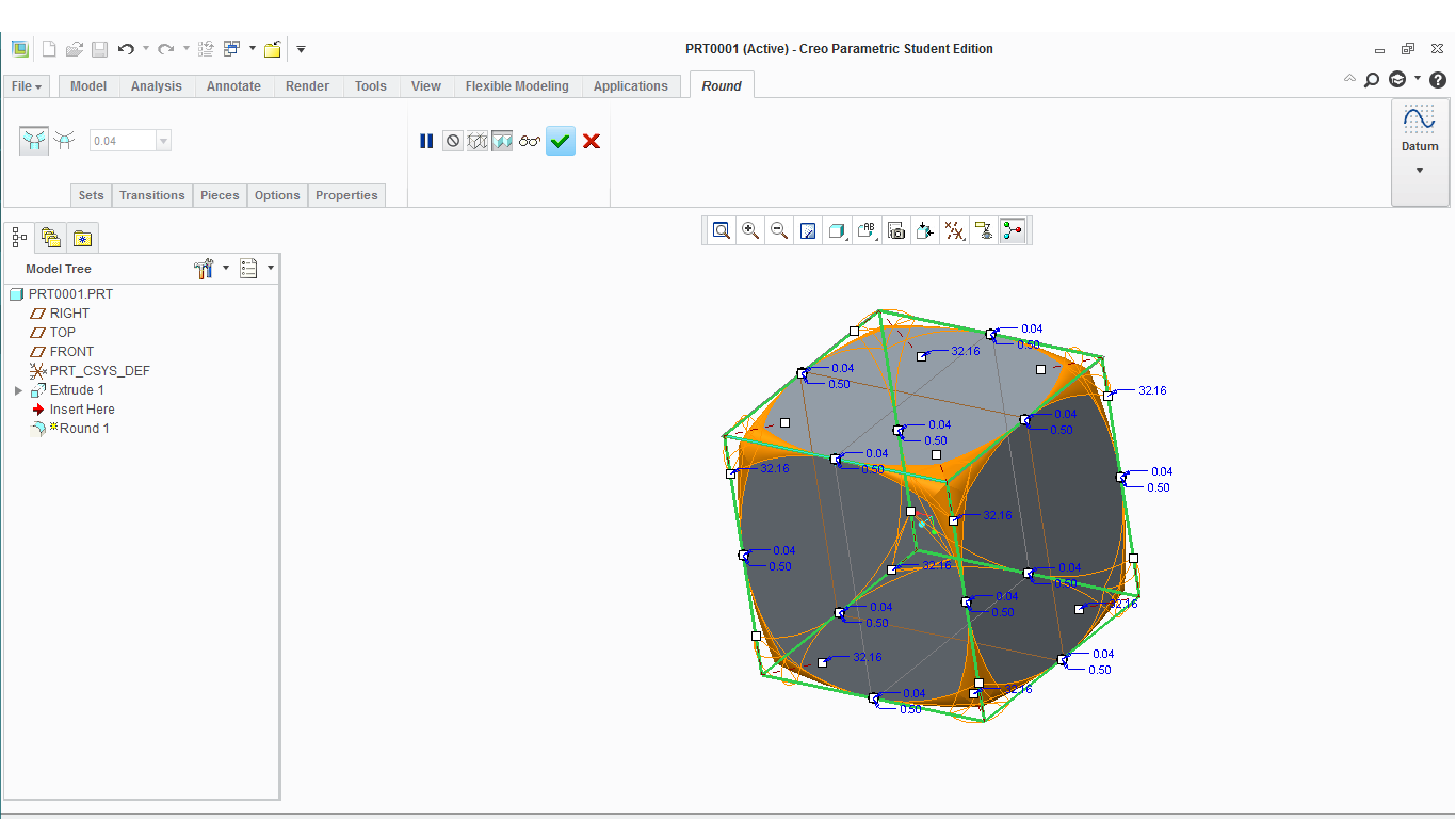

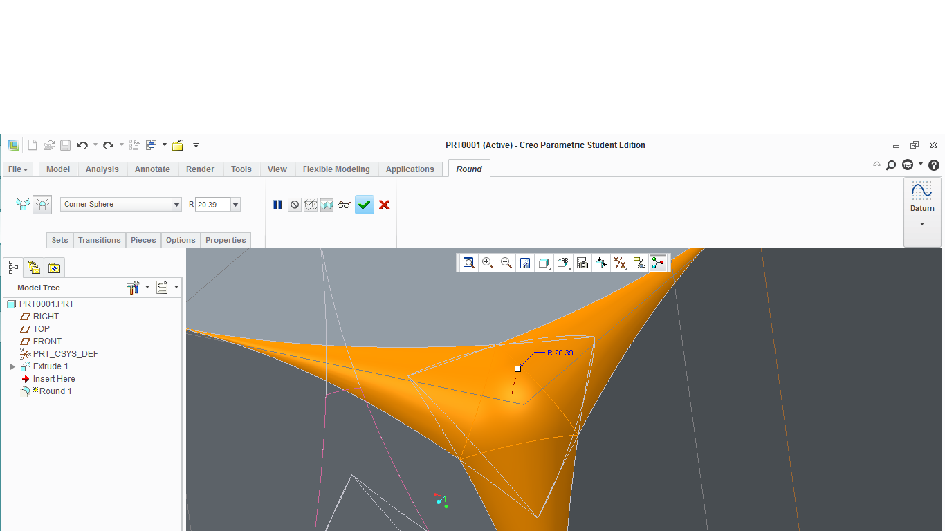

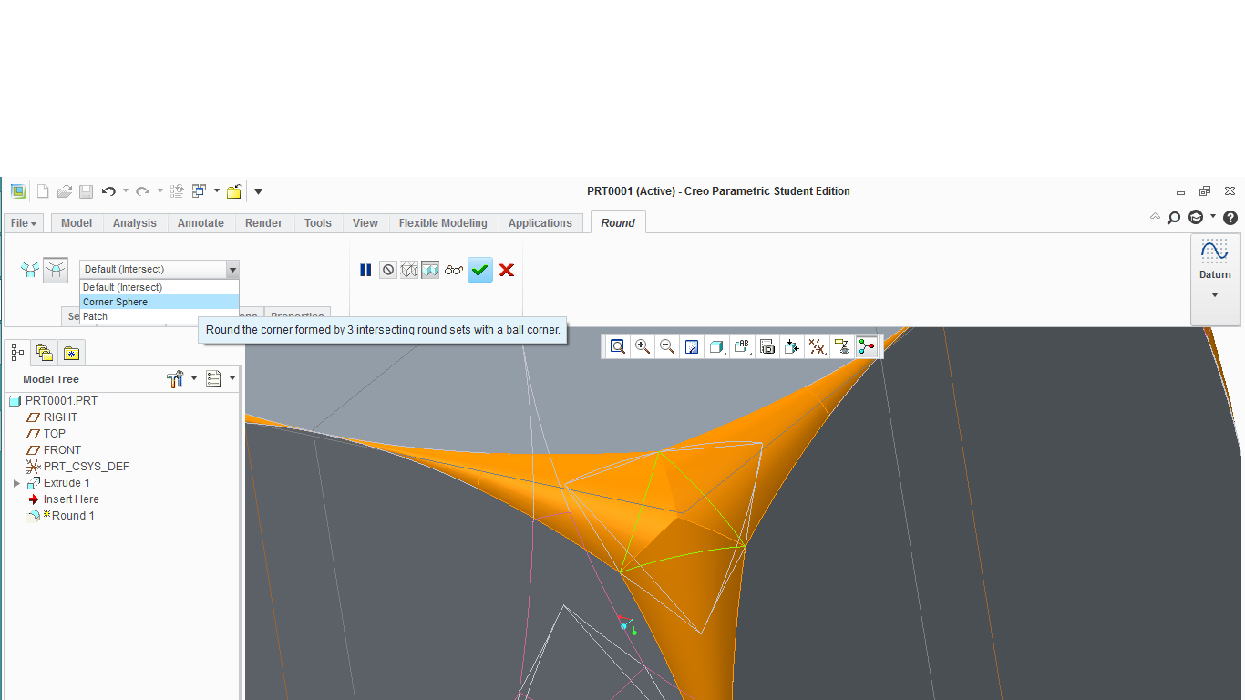

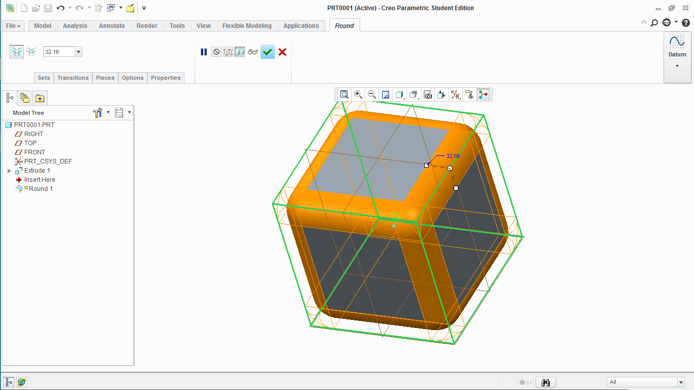

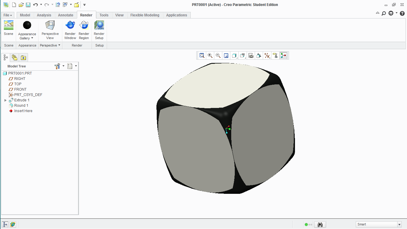

    Two step solution,
    Use a variable round and use the add radius option and place these points between the corners, now give them a tiny value. Next, you can use the corner sphere transition and that's it.
    The model was created in Creo Parametric 2.0 Student Version, sorry for that.

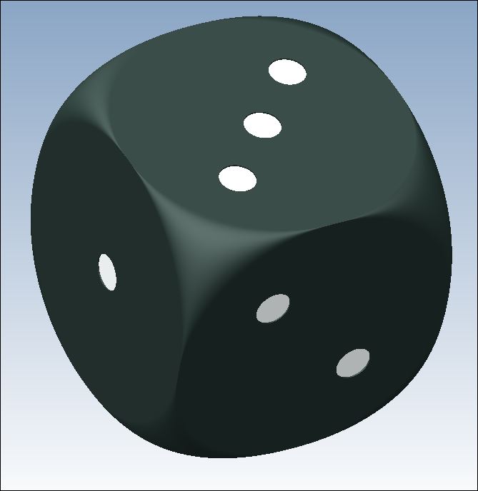

    Look this dice.
