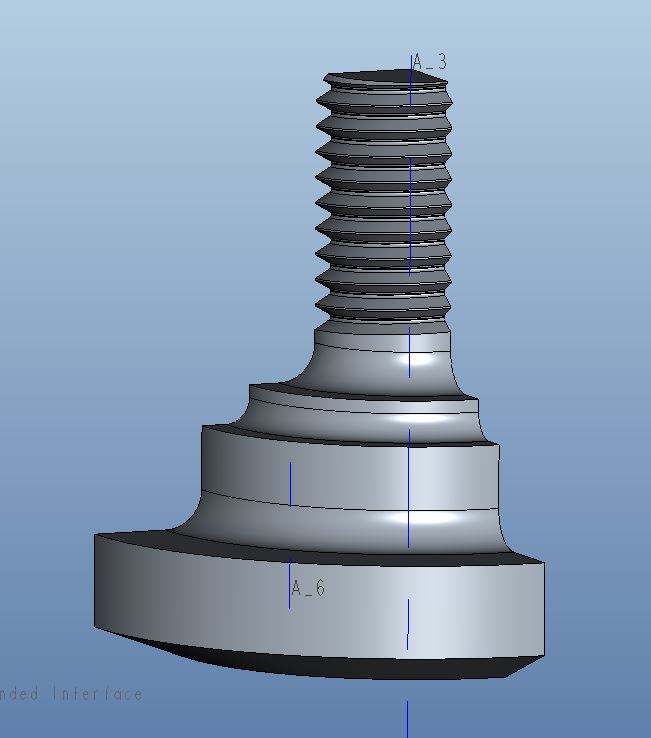

For example, I'm trying to do a 3d mesh on this quarter of screw.
How can I do otherwise?

    Your thread is a helix though. You would have to compromise and make the thread a revolve.
    Regards
    Jan 12, 2016 7:48 AM UTC
    This was possible in the old Mechanica Independent mode... But as Charles pointed out, you would then have to compromise and make the thread as a revolve,not a helix. And if you do a revolve, then I'd model it one element thick, as an "almost 2D"-model. And if you do that, no element can touch the revolve axis at a corner; all elements must have an edge along the revolve axis. There are no elements that describe the shape of a triangle or quad revolved around an axis that intersects only a corner of that tri/quad.

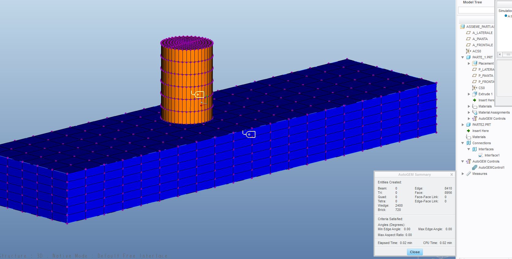

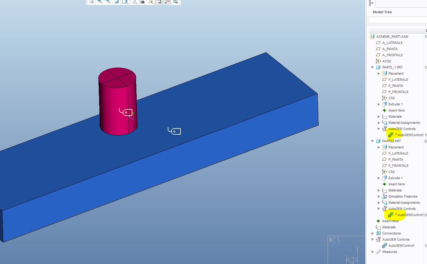

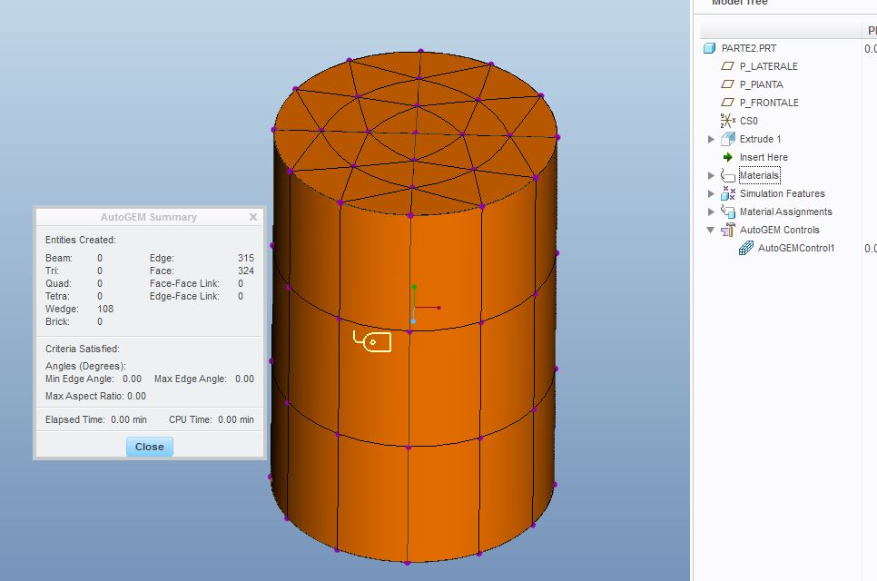

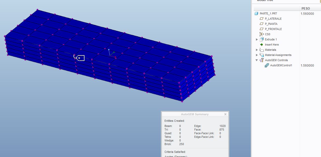

    This morning I've tried make a new assembly of test, with 2 simple parts; each of them has been mesh separately inside of own part.
    Results: while each part has been mesh correctly by the own mapped mesh tool, within the assembly the "sub tool of mapped mesh" doesn't work.
    Appear a little yellow triangle near the command.
    There is a manner that permit to you to "resume" the mapped mesh inside each parts? Some option. Or you must, always, make a giant mapped mesh in the main assembly?

    Ah yes,
    Mapped mesh controls are suppressed if defined at part level. Only the Assy level mapped mesh controls work.
    I can't remember if the behaviour is the same with prismatic elements & thin.
    Other mesh controls work if defined at part level,
    What I will say is that it is possible to get reasonable pressure plots with tets now with the right refinement. This applies equally to a regular mesh. I have examples somewhere.

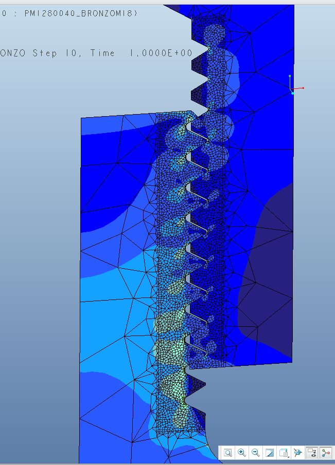

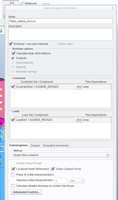

    Jan 20, 2016 7:22 AM UTC
    I've done a simple revolve assembly, meshed with tetras and contacts with finite friction; cyclic symmetry constraint.
    As in the helical assembly, the analysis doesn't converge at the beginning.
    I noted that in reality the analysis doesn't converge only at the 2° pass of the Single Pass Analysis.
    The 1° pass, where all the p-elements have a polynomial of third degree, has always been completed.
    I've tried analysis with:
    - Automatic steps within range
    - User-defined output steps
           - 20 and 40 steps
           - Auto definition of steps
           - user definition of time step with the first 10 pass very small
    but the result is always the same: the quick check analysis goes and in the single pass goes only the 1° pass.
    Jan 20, 2016 9:08 AM UTC
    I too often find that it is difficult for the solver to converge at pass 2 for nonlinear problems. The workaround I use is to run a quick-check with a fine mesh.
    gfraulini17-PeridotAuthor
    Jan 20, 2016 9:26 AM UTC
    It would be fine if PTC explain why this happens...
    Anyway I think your workaround is the best choice.
    For the choice of the time step, which of the many options do you prefer and in which cases?
