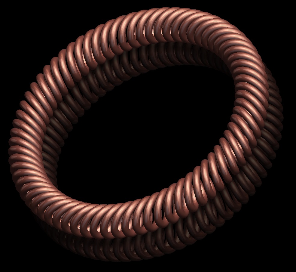

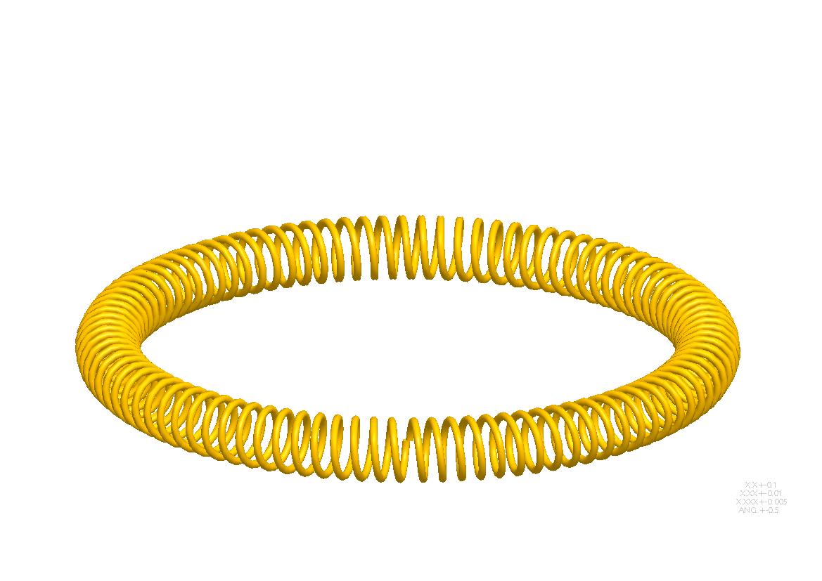

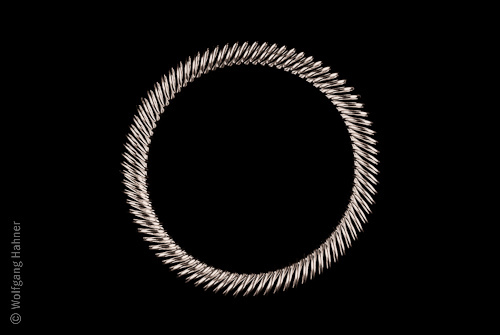

Hi all,
I'm attempting to model a canted coil spring in WF4.0 but have only managed to model what is in effect a 'garter spring'. The difference being the coils of the canted spring are not perpendicular to the trajectory but are 'canted' over at an angle.
These are sometimes referred to as 'Balseal' springs.
Can anyone offer any help on this please?
I've attached an image of the spring I've modelled as well as a photo of a true canted coil spring.
Any help appreciated.
Thanks.

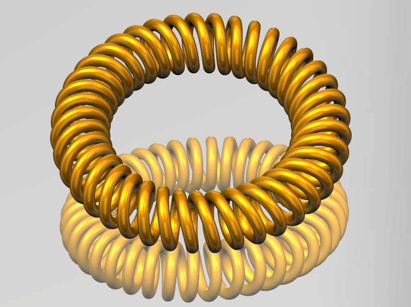

    June 10, 2013
    Nope... Spinal bend! (Frank would be proud!)
    Wrap a sketch around a cylinder using a curve. Something like this: ~
    Pattern the sketch and use it for a sweep of a line (to get a surface for the spinal bend)
    Spinal Bend the surface
    Use the surface edge for a sweep
    Remember the limitations of Spinal Bend doesn't allow geometry beyond the two datum planes. You need to be very specific about the end conditions.
    I'll post up the process I used in a bit.

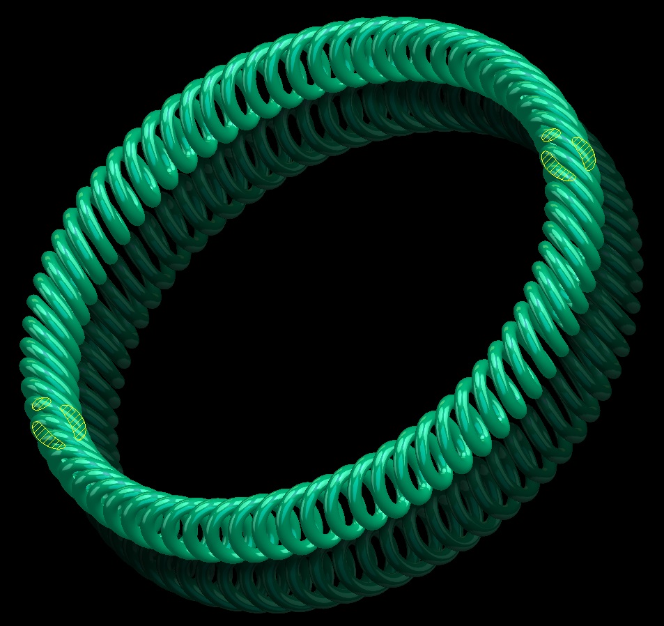

    Ok, so here's my take. Anyone wanna try it in less than 6 features?
    June 11, 2013
    Very nice!
    Patriot_1776
    June 11, 2013
    Thanks! Check your personal (not here) e-mail, I sent you and Brian a file.

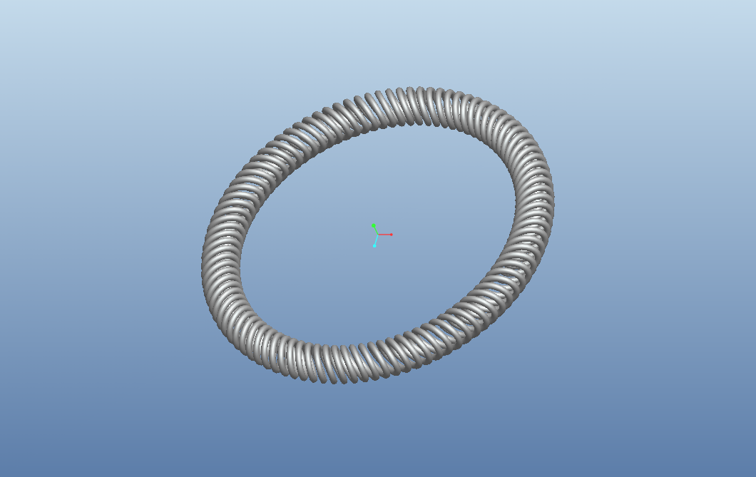

    please check this.if this is what you require.
    June 11, 2013

    Without actually seeing one, the question is: If you section the spring thru the toroidial axis, is the cross-section of the spring circular, or elliptical (as shown). If the manufacturing method is take a cylindrical, helical spring, "smear it" as if the side view was now a trapezoid instead of a rectangle, then you end up with an elliptical section. If the spring has a perfectly round cross-section, then a slightly different method is used, and/or the spring starts out NOT cylindrical.
    Interesting either way and it's also do-able either way, now with 4 features (from 6). I'd sure like to get my hands on a large one to look at it.

    Frank, these are often used in axle seals for your car. You should be able to find one in any wrecking yard.
    This is a patent page that shows them oval in section:
    https://data.epo.org/publication-server/rest/v1.0/publication-dates/19920624/patents/EP0491258NWA1/document.html
    Go to the end of the document.
    edit: the Bal Seal catalog pretty much confirms this too
    http://www.balseal.com/sites/default/files/rotarycatalog_092506044932.pdf
    This just means you need to intersect an appropriate elliptical surface with the spun surface. ...or the equation curve with the driving sketch to manage the height to the width.

    I saw that, and agree that the cross-section should be elliptical. I also did a "-02" version where, unlike the green coil above, the cross-section IS perfectly circular. It was actually pretty easy to modify the -01 file (when I was removing a couple unneccessary curve features).
    I think they probably manufacture the coils like we thought, by "squishing" or "smearing" them, so they end up elliptical.
