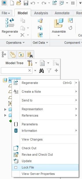

In Creo integrated with Windchill, the top level assembly only is checked-out , and bottom parts are in check-in status.
Can we put a lock to the bottom parts to prevent them from modification using ProToolkit API?
In interactive mode it is supported (PFA).
January 6, 2017
You can't prevent it. But you can check it inside your toolkit program before you change it from this side.

January 6, 2017
As far as I know you can only check the status.
Function ProServerObjectIsModified
