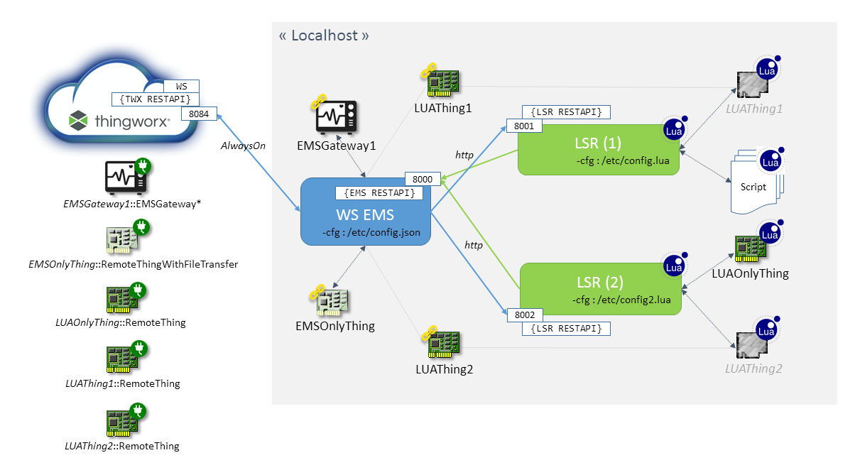

In this blog I will be inspecting the setup below, using the REST APIs exposed by the different components (log-analysis-free guaranteed).
The components are started in stages, and I will do some exploration between each stages :
  • EMS only
  • EMS + LSR 1
  • EMS + LSR 1 + LSR 2
 The REST APIs
  • Edge MicroServer (EMS) REST API
    • This API is very similar to the ThingWorx platform REST API, see REST APIs Supported by WS EMS for specificity.
    • I will be monitoring the EMS using the LocalEms virtual Thing (EMS only)
    • I will be monitoring the EMS, from the platform, using an EMSGateway thing.
      • The EMSGateway exposes on the platform some of the LocalEms services (like GetEdgeThings).
    • I'm also inspecting the remote properties / services / events exposed on the things using the RemoteThing::GetRemoteMetadata service.

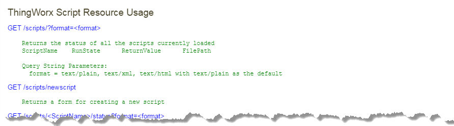

  • Lua Script Resource (LSR) REST API
    • This API largely differs from the ones above, the API documentation is served by the LSR itself (e.g. http://localhost:8001/)
    • I will use it to list the scripts loaded by the LSR process.
 Configuration
See above diagram - Platform is listening on port 8084, no encryption, EMS and LSRs on the same host...
  • Platform configuration : for each edge thing, a corresponding remote thing was manually created on the platform
    • EMSGateway1 as a EMSGateway Thing Template
    • EMSOnlyThing as a RemoteThingWithFileTransfer
    • LUAThing2 as a RemoteThing
    • LUAThing1 as a RemoteThing
    • LUAOnlyThing as a RemoteThing
  • EMS configuration : /etc/config.json - listening on default port 8000

  • LSR process (1) : /etc/config.lua - listening on default port 8001 (using the out of the box sample Lua scripts)
scripts.log_level = "INFO"
scripts.LUAThing1 = {
    file = "thing.lua",
    template = "example",
scripts.sample = {
  file = "sample.lua"
  • LSR process (2) : /etc/config2.lua - listening on port 8002 (using the out of the box sample Lua scripts)
    • This LSR process is started with command "luaScriptResource.exe -cfg .\etc\config2.lua"
scripts.script_resource_port = 8002
scripts.LUAThing2 = {
    file = "thing.lua",
scripts.LUAOnlyThing = {
    file = "thing.lua",

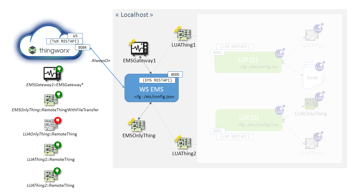

Stage 1 : EMS only
ThingWorx REST API
Request: Call the GetEdgeThings service on the EMSGateway1 thing
POST  twx74neo:8084/Thingworx/Things/EMSGateway1/Services/GetEdgeThings
Response: As expected, only the remote things flagged as auto_bind are listed
name host port path keepalive timeout proto user accept
EMSGateway1   8001.0 / 60000.0 30000.0 http   application/json
EMSOnlyThing   8001.0 / 60000.0 30000.0 http   application/json
LUAThing1   8001.0 / 60000.0 30000.0 http   application/json
LUAThing2 localhost 8002.0 / 60000.0 30000.0 http   application/json
Request: Call the GetRemoteMetadata service on the LUAThing1 thing
POST  twx74neo:8084/Thingworx/Things/LUAThing1/Services/GetRemoteMetadata
Response: As expected, remote properties / services and events are not available since the LSR associated with this thing is off.
  Unable to Invoke Service GetRemoteMetadata on LUAThing1 : null
EMS REST API
Request: Call the GetEdgeThings service on the LocalEms virtual thing
POST  localhost:8000/Thingworx/Things/LocalEms/Services/GetEdgeThings
Response: output is identical to the gateway thing on the platform
{ "name": "EMSGateway1", "host": "", "port": 8001, "path": "/",  "keepalive": 60000, "timeout": 30000, "proto": "http", "user": "", "accept": "application/json" },
{ "name": "EMSOnlyThing", "host": "", "port": 8001, "path": "/", "keepalive": 60000, "timeout": 30000, "proto": "http", "user": "", "accept": "application/json" },
{ "name": "LUAThing1", "host": "", "port": 8001, "path": "/", "keepalive": 60000, "timeout": 30000, "proto": "http", "user": "", "accept": "application/json" },
{ "name": "LUAThing2", "host": "localhost", "port": 8002, "path": "/", "keepalive": 60000, "timeout": 30000, "proto": "http", "user": "", "accept": "application/json"}
LSR REST API
N/A - no LSR process started yet.

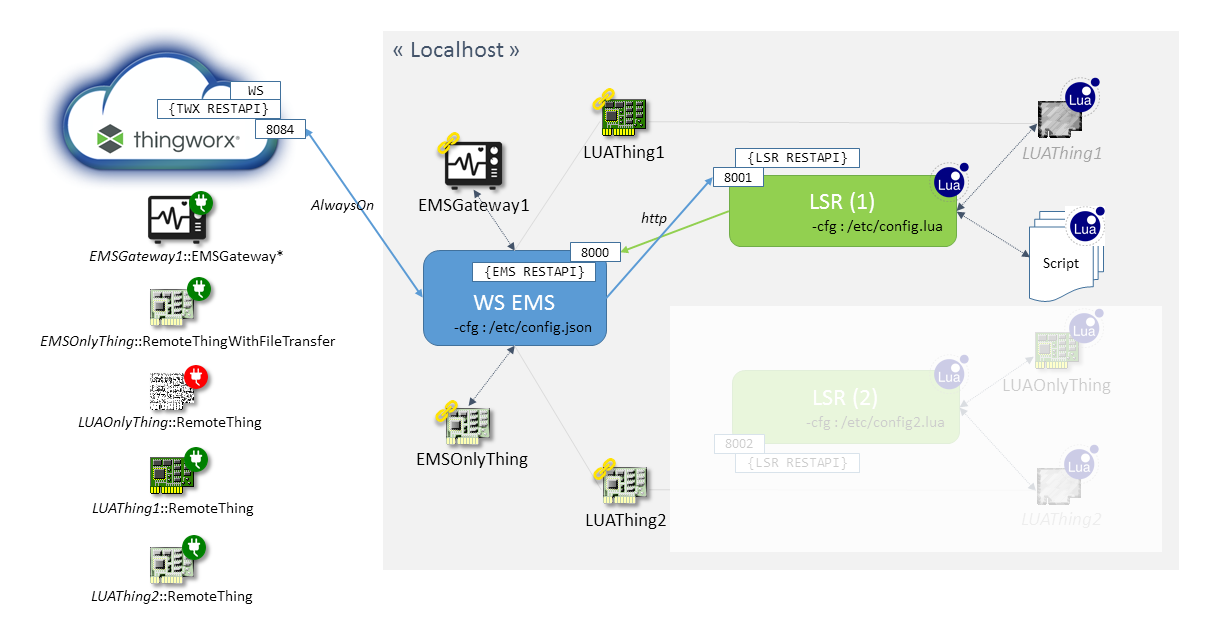

Stage 2 : EMS + LSR 1 (8001)
ThingWorx REST API
Response: LUAThing1 is associated to an LUA script
LUAThing1 localhost 8001.0 /scripts/Thingworx 60000.0 15000.0 http   application/json
Response: Now that the Lua script for LUAThing1 is running, remote properties / services and events are available
  {"isSystemObject":false,"propertyDefinitions":{"Script_Pushed_Datetime":{"sourceType":"ThingShape","aspects":{"isReadOnly":false,"dataChangeThreshold":0,"defaultValue":1495619610000,"isPersistent":false,"pushThreshold":0,"dataChangeType":"VALUE","cacheTime":0,"pushType":"ALWAYS"},"name":"Script_Pushed_Datetime","description":"","category":"","tags":[],"baseType":"DATETIME","ordinal":0},"Pushed_InMemory_Boolean":{"sourceType":"ThingShape","aspects":....
EMS REST API
     LocalEms::GetEdgeThings returns same output as EMSGateway::GetEdgeThings
LSR REST API (port 8001)
Request: List all the scripts running in the first LSR
GET  localhost:8001/scripts?format=text/html
Response: We find our sample script and the script associated with LUAThing1 (the Thingworx script is part of the infrastructure and always there)
Name Status Result File
LUAThing1 Running   E:\ptc\ThingWorx\EMS-5-3-2\etc\thingworx\scripts\thing.lua
sample Running   sample.lua
Thingworx Running   E:\ptc\ThingWorx\EMS-5-3-2\etc\thingworx\scripts\thingworx.lu

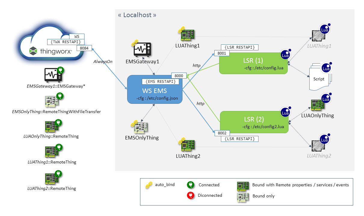

Stage 3 : EMS + LSR 1 (8001) + LSR 2 (8002)
ThingWorx REST API
Response: LUAOnlyThing is now listed and LUAThing2 is associated with a LUA script
LUAOnlyThing localhost 8002.0 /scripts/Thingworx 60000.0 15000.0 http   application/json
LUAThing2 localhost 8002.0 /scripts/Thingworx 60000.0 15000.0 http   application/json
EMS REST API
LSR REST API (port 8002)
Request: List all the scripts running in the second LSR
GET  localhost:8002/scripts?format=text/html
Response: Returns the status of all the scripts currently loaded
LUAOnlyThing Running   .\etc\thingworx\scripts\thing.lua
LUAThing2 Running   .\etc\thingworx\scripts\thing.lua
Thingworx Running   .\etc\thingworx\scripts\thingworx.lua
