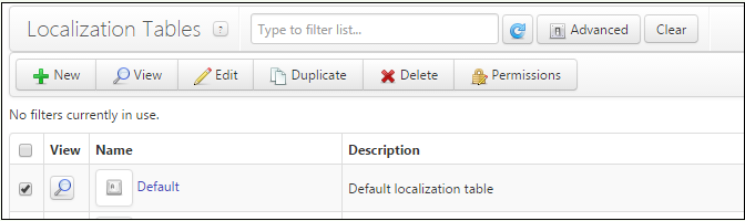

Create a Localization Table

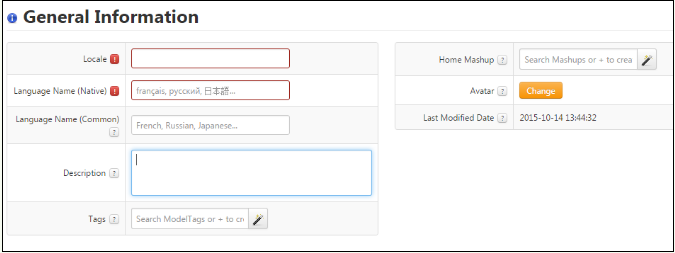

You create a Localization Table entity when you need to add support for another language to the application you're developing. Someone from Sales has said "There's an opportunity if we can deliver the Spiffy application in Estonian." This suggests that an Estonian-speaking end user should be able to run Spiffy and see all of its labels, messages, prompts, dialogs, and so on in Estonian. Most of the cost of adding Estonian language support is in a (usually contracted) service that does the English-to-Estonian (or whatever target language) translations. Such services employ native speakers who can get the nuances of translation correct. See Tips for translators below for suggestions on improving the accuracy of the translation.

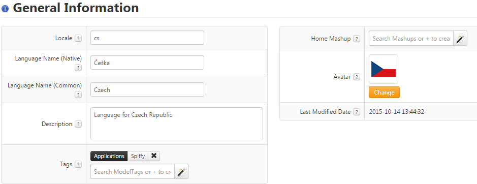

In Composer, view the Localization Tables list. Begin by duplicating an existing table (e.g. check Default or another language and click Duplicate) or by clicking New.
A new tab will open with a New Localization Table in edit mode.
The fields shown are:
  • Locale (required). This is the official language tag of the new language. Language tags are defined by an Internet standard, IETF BCP 47. Briefly, they consist of a standard abbreviation for a language (e.g. en for English, de for German), followed optionally by a script subtag (e.g. Cyrl for Cyrilic), followed optionally by a region code (a country code, such as CH for Switzerland or HK for Hong Kong, or a U.N. region number), followed optionally by other qualifiers such as dialect. A simple example is es, Spanish. A complex one is sl-Latn-IT-nedis, Slovenian rendered in Latin characters as spoken in Italy in the Natisone dialect. Software rarely needs such highly specific language tags; the most specific practical examples are the various scripts and regions for Chinese (e.g. zh-Hans-CN, zh-Hant-TW).
  • Language Name (Native) (required). This is the name of the language as written in that language, such that it would be readable by a native speaker. For example, 日本語 for Japanese, ਪੰਜਾਬੀ ਦੇ for Punjabi, or Deutsche for German.
  • Language Name (Common). This is the name of the language as written in a common administrative language. For an application delivered internationally, English is probably a safe choice. Administrators at a customer site might change these to be in the language of the headquarters country.
  • Description. Free form text describing the language. This will appear to end-users as a tooltip as they hover over language choices.
  • Tags. Standard ThingWorx entity tags.
  • Home Mashup. Does not apply.
  • Avatar. An icon for this language. The default is screencap%2020151014-140342.png?version=1&modificationDate=1444849438618&api=v2. No other icons are delivered as standard, but language selection interfaces in many products use national flags to help distinguish choices, and those could be supplied here. Avatars are 48x48px images. There may be political implications in choosing a flag or other symbol for a language; use caution.
Note that subtags of a language tag are separated by a hyphen, as in zh-Hans-SG. Using underscore is a Java convention that does not conform to BCP 47.A complete properties definition for Czech might look like this:

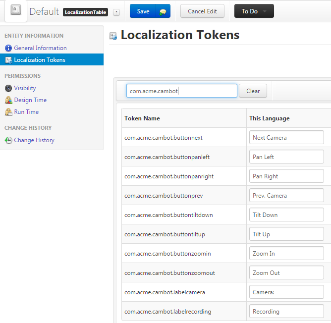

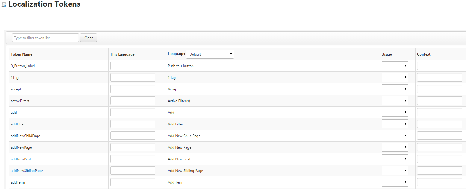

Once the table has been created and saved, you can edit the translated text in Composer. Under Entity Information, select Localization Tokens. A grid similar to this will appear:
The columns shown are:
  • Token Name. This is the symbol used by mashup developers to insert a localized string into a certain place in a widget. For example, no matter how the phrase "Add New Page" is rendered (Neue Seite hinzufügen, Adicionar nova página, 새 페이지 추가...) the application developer is only concerned that the token addNewPage appears on the proper widget. See How tokens are resolved below for more information.
  • This Language. How the text is to be represented in this language, that is, the language of the Localization Table currently being viewed or edited.
  • Language. How the text has already been represented in any other language currently defined on the system. This is simply for reference purposes, to compare one translation with another.
  • Usage. Can be set to Label, Message, or left unspecified. This is a guide to translators, who have to be concerned about the size of translated text. Usage Label suggests that the text needs to fit in a confined space, such as in a column header or on the face of a button. Usage Message suggests that the text is meant for a popup, error message, help, or somewhere that full sentences can be accommodated.
  • Context. This is a free-form text field to provide instructions, advice, context, or other explanatory material to the translator. For the token book, for example, the context field can distinguish between the senses of book (something to read), book a table, book a sale, or book a prisoner, which may all have different translations.

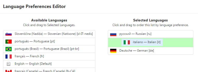

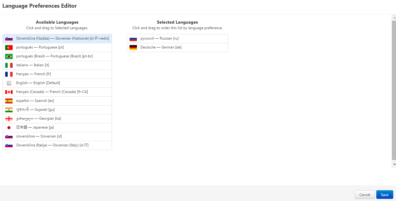

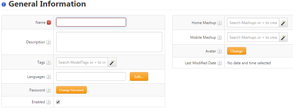

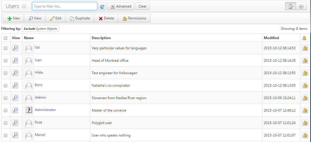

Define language preferences for a user
The reason for localization is to present user interfaces in the best language for a given user. To support this, each ThingWorx user is associated with one or more languages – those that that user can read comfortably. Some applications might offer just one language or a few, some many, and the supported languages may or may not overlap. So each user defines an ordered preference list, saying in effect: my best language is Catalan, but I'm decent in Spanish, and if those aren't available I did spend a few years in Hungary, and as a last resort there was some French in school. This would be represented in ThingWorx as: ca,es,hu,fr. A user from Scotland might have language preference en-UK,en, meaning that English with United Kingdom spellings and vocabulary is best (tyre, windscreen), but if not available then any English will do (tire, windshield). (It is not necessary to spell out related preferences of this type – see How tokens are resolved.) Any application then interacts with a given user in the best language that the application and user have in common.To define the language preference(s) for a user, open the Users list in Composer:
Then choose an existing user to edit, or click New to create a new account.
The only localization related information here is the Languages field. An administrator who knows the names of available languages may edit or paste an ordered, comma-separated list into the Languages field (e.g.  ca,es,hu,fr-CA). Clicking the Edit... button brings up a drag-and-drop preferences editor:
The column on the left shows available (unselected) languages. The column on the right shows this user's languages, with the top entry being the most preferred language. Dragging a language from left to right adds it to the user's list; from right to left removes it; dragging rows up and down on the right changes the preference order. As language entries are dragged, a highlight appears to show where they might be dropped:
A user with no language preference set will have all tokens resolved from the Default and System tables. Language Preferences can be set programmatically, as detailed in KCS Article CS243270.

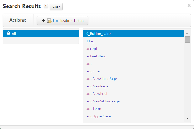

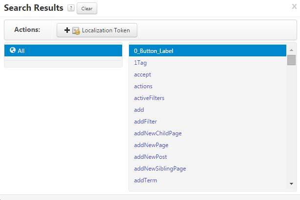

Clicking the magic wand icon opens the localization token picker:
The list of tokens on the right corresponds to the Token Name column in the Localization Table editor. This is the key that is common to the meaning of a word or phrase, independent of its translation into natural languages. Select one from the list, or click screencap%2020151014-152203.png?version=1&modificationDate=1444854135647&api=v2 to create a new one. Enter the token name and its Default (usually English) value:
Note that, complying with best practices for extension developers, the token name has been namespaced: this token belongs to Acme Inc.'s Spiffy application. The rest of the name is descriptive and may reflect other development standards.When a new token is created, it becomes available to edit in every configured Localization Table. If these are not updated, then the default (English) value will be shown wherever the token occurs.

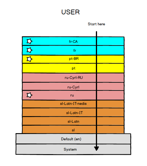

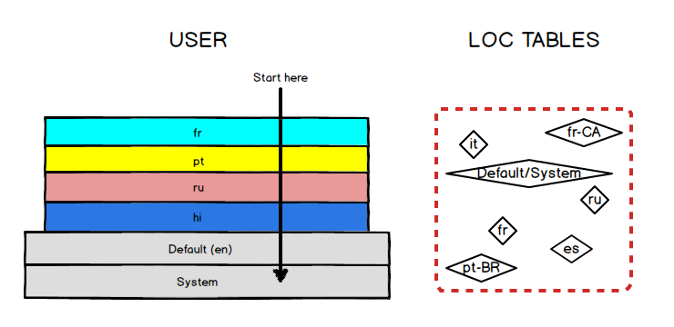

What happens at run time when the UI needs to display the value of a localization token? The answer is determined by
  • the current user's language preferences
  • the set of Localization Tables configured on the system
  • the presence or absence of a translation for a given token in a given table

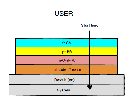

To visualize this, picture the user's language preferences as a stack, with the most preferred language on top and the least one sitting on the floor – where the floor consists of the Default and System Localization Tables:
The user's language preference is fr,pt,ru,hi (French, Portuguese, Russian, Hindi, with French most preferred). The system is configured with Localization Tables, which have no order, for it (Italian), fr-CA (Canadian French), ru (Russian), pt-BR(Brazilian Portuguese), es (Spanish), and the default (likely Engish). Now the UI needs to present this user with the best value for the token com.acme.spiffy.labelAssembly.
To resolve this, we start at the top of the stack. Is there a fr Localization Table? There is. Does it contain a translation for com.acme.spiffy.labelAssembly? For the sake of illustration, assume that it does not – perhaps other applications have French support, but the Spiffy application doesn't, so there aren't any com.acme.spiffy.* tokens in the French Localization Table. So we still need a value. Continuing down through the user's preferences, the next acceptable language is pt. Is there a pt localization table? No. There is a Brazilian Portuguese translation, but that won't help a user from Portugal. Still looking, we move to the next language, ru. Is there a ru Localization Table? There is. Does it contain a translation forcom.acme.spiffy.labelAssembly? It does: Ассамблея – so the token has a value, and that is what gets displayed in the UI.
Suppose that the user's preferences were more specific, something like this:
The users's language preference is fr-CA,pt-BR,ru-Cyrl-RU,sl-Latn-IT-nedis (Canadian French, Brazilian Portuguese, Russian in Cyrillic characters as used in Russia, Slovenian in Latin characters as used in Italy where the Natisone River dialect prevails). ThingWorx treats this by internally expanding the stack to include acceptable fall-back languages. In effect, it looks like:
Of the four languages that the user can accept and that the system defines (fr-CA, fr, pt-BR, ru) the first one containing the desired token determines its value in the UI.

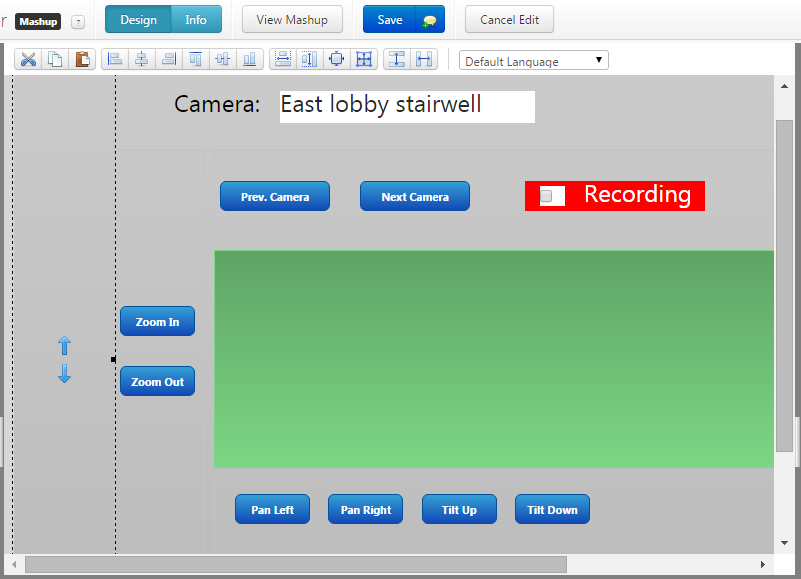

ACME, Inc. is developing a ThingWorx application called Cambot for controlling security cameras. ACME's developer begins by constructing a mashup:
This is the first draft. There is an area for the video widget, to be added later, and some button and label widgets for choosing and controlling a camera. The widgets have been given static labels:
As shown here, the text for the pan left button has been entered simply as "Pan Left."

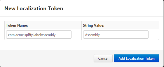

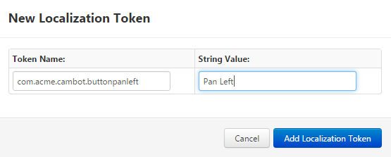

But the Cambot app needs to be localized, and delivered in English, French, and Spanish. The next step for the developer is to replace all of the static text with localization tokens. Clicking the globe icon to the left of the label property changes the text from static to tokenized: localization_blog_pic19.png and adds a magic picker for localization tokens. This is a new application, and will need its own set of localization tokens. To create the one for "Pan Left," click the magic wand to open the tokens picker:
and then click "+ Localization Token" to add a new one. A dialog opens prompting for the token name and its default (English) value:
Note that the token name has been namespaced for two reasons: to prevent conflicts with tokens from other sources, and to allow the developer and translators to work only with application-specific tokens. On clicking "Add Localization Token," the token is created and the default value saved. The mashup builder now shows: localization_blog_pic22.png.

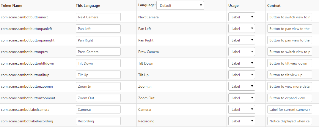

After all of the tokens needed by the application have been defined, they and their values may be seen on the Localization Tokens editor for the Default Localization Table. By entering the namespace prefix in the filter textbox, the display can be restricted to the tokens for this application:
As application development continues, and more tokens are required, this process is repeated. When tokens are defined, the developer should edit the Default Localization Table to supply Usage and Context information for each one:

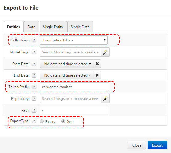

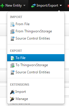

Finally, it's time to do the translations for French and Spanish. First, create the localization tables for those languages, as described above in "Create a Localization Table."

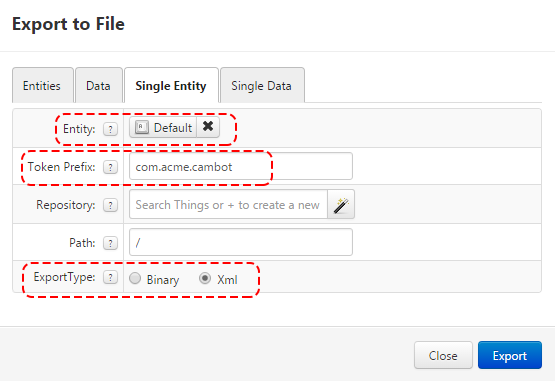

From the Import/Export menu, select EXPORT / To File:
Then, depending on the file format desired, choose either the Entities or Single Entity tab. For Entities, set the Collections value to Localization Tables, enter the namespace in the Token Prefix field, and choose XML as the Export Type:
This will produce a single output file, containing a Localization Table element for every language defined on the system – in this example, English, French, and Spanish -- but including only the com.acme.cambot tokens.
For Single Entity, choose the language to export, specify the prefix, and choose XML:
This must be repeated, once for each language, and creates a separate XML file for each. In either case, the translator should be supplied with the Default XML and the file for the language to be added. (Or, the tokens and values may be converted to and from other formats, depending on the requirements of the translation service. In any case, the translated values must be in the same XML format before they can be imported.)

In this example, the token defined in lines 2 through 7 is missing the translation cues usage and context. The translator's only option is to intuit the sense of "Part" – is it a noun or a verb? – and attempt a reasonable guess. Access to a running example of the application would clearly be helpful. Lines 8 through 13 identify a label and describe how it is used; lines 14 through 19 do the same for a message. The translator would know that space for the translation of "Assembly" might be limited but that the warning message can be expressed naturally.
A translator working on French might then edit this file as follows (again, only the <Rows> element is illustrated):

Note that only the <value> elements need to be translated – the context and usage are hints for the translator.
