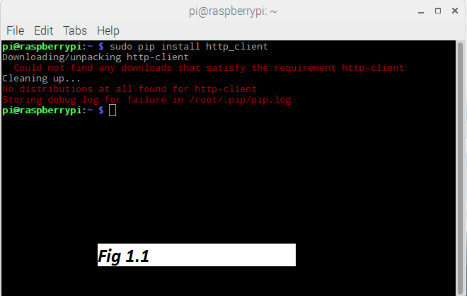

1.(Issue on Rapberry PI)
  I have tried below steps.
  2. from the PI run 'sudo pip install requests' -(Result: Successful)
  3. from the PI run 'sudo pip install logging' -(Result: Successful)
  4. from the PI run 'sudo pip install http_client' --(Result: Failure)
  When I am trying to execute step 4 , I am getting one issue. Please find screenshot (fig 1.1)

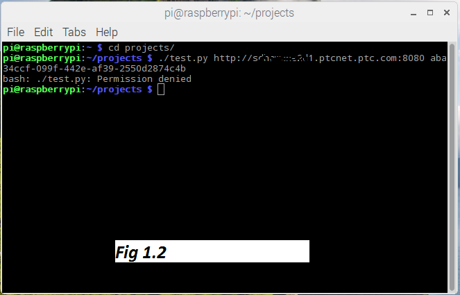

Further I tried executing python code on PI, its giving error as Permission denied.
  Please find screenshot (fig 1.2)

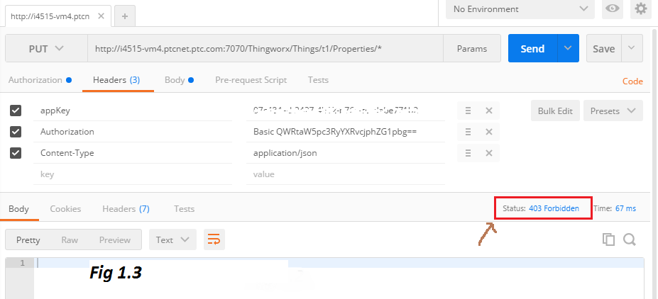

2. (Issue while posting data on VM using REST call and Postman)
  When I am trying to push data on VM, I am getting issue as 403 Forbidden.
  And on thingworx log I can see "Error occurred while validating HTTP header: cookie" this error.
  Please find screenshot (fig 1.3)

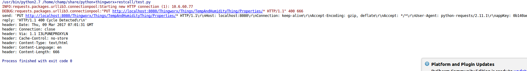

Mar 9, 2017 7:12 AM UTC
Hi Bill ,
       i have tried what you explained in this blog but getting an error
Thanks & regards
        Pravin
Mar 9, 2017 7:34 AM UTC
Try this approach. Add this line to python script, this line will push the data to Thingworx.
r = requests.put("http://localhost:8080/Thingworx/Things/TempAndHumidityThing/Properties/(name_of_the_property&remove_brackets)?method=put&value=45", auth=('your_username', 'your_password'),headers=headers)
for ex.
r = requests.put("http://localhost:8080/Thingworx/Things/TempAndHumidityThing/Properties/PropTemp?method=put&value=45", auth=('abc', 'xyz'),headers=headers)
you can also print the response code to verify whether data sent or not. below is the python script to print the status
print "Response code {0} ".format(r.status_code)
Sachin Dhawane.
Mar 9, 2017 8:48 AM UTC
Hi sachin Dhawane,
  for permission denied. use  Sudo bash or sudo su (which makes you to execute command in root mode)
regards
Dinesh
Mar 9, 2017 9:04 AM UTC
Thanks sachin for reply
      i tried the same but its giving the error code 400, how to solve it? is it bcoz of server problm?
