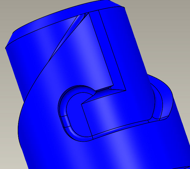

I'm not sure exactly what his geometry looks like but this is one I worked on. We never really got it truly correct to manufacturing.
Sweeping a ball end mill or radius end mill along a 3d path can't be duplicated precisely with Creo.

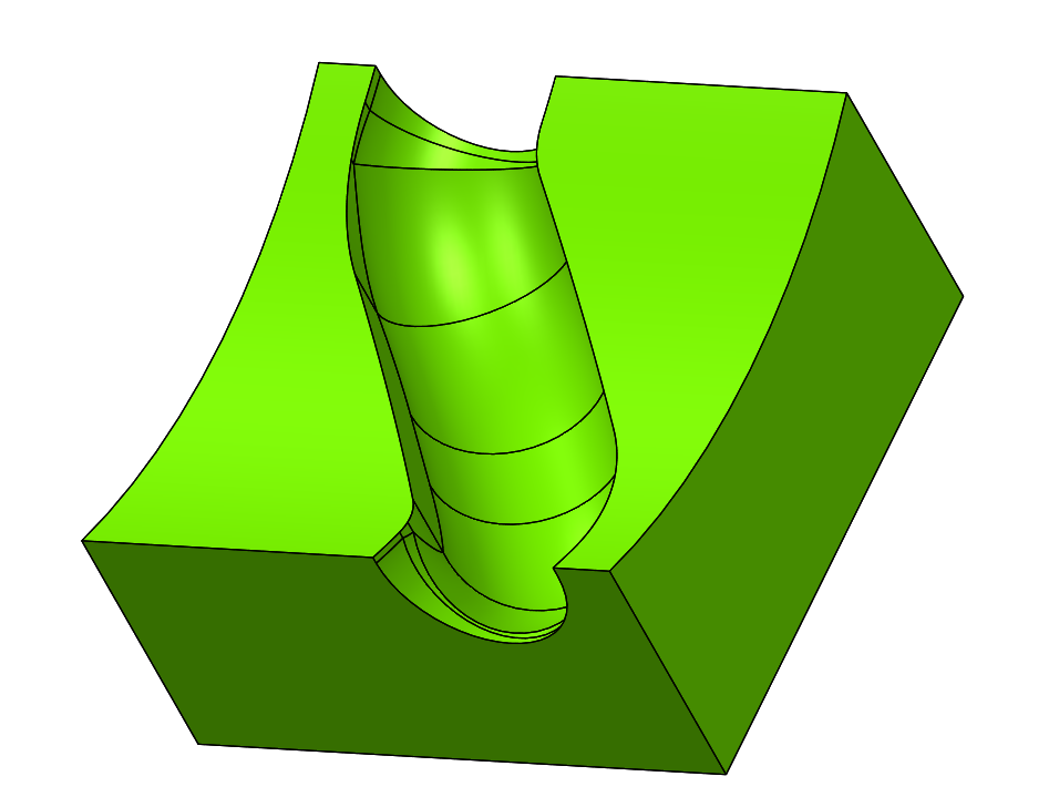

The ball mill is by far easier than a flat end
This is what I'm toying with...
