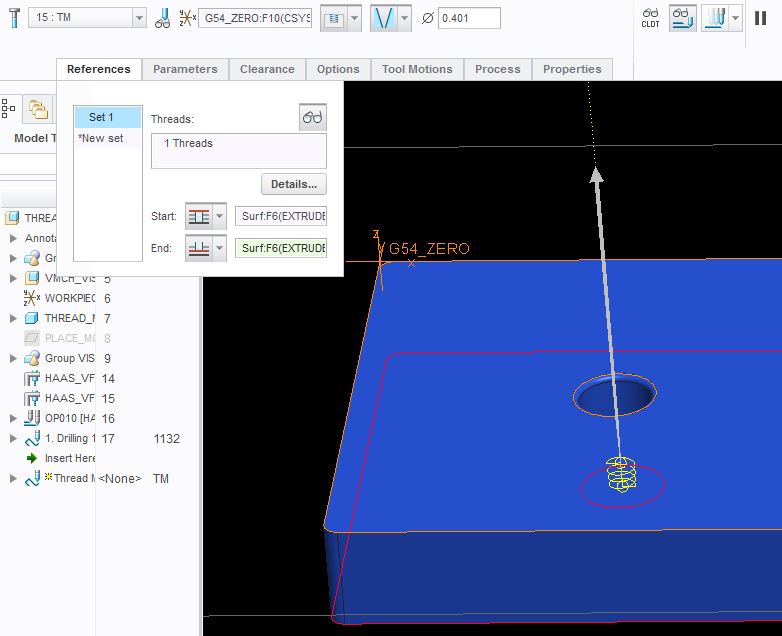

  3. Placement of the thread when choosing start and end.  I am having problems with the placement of the thread, I have attached screenshot to help explain.

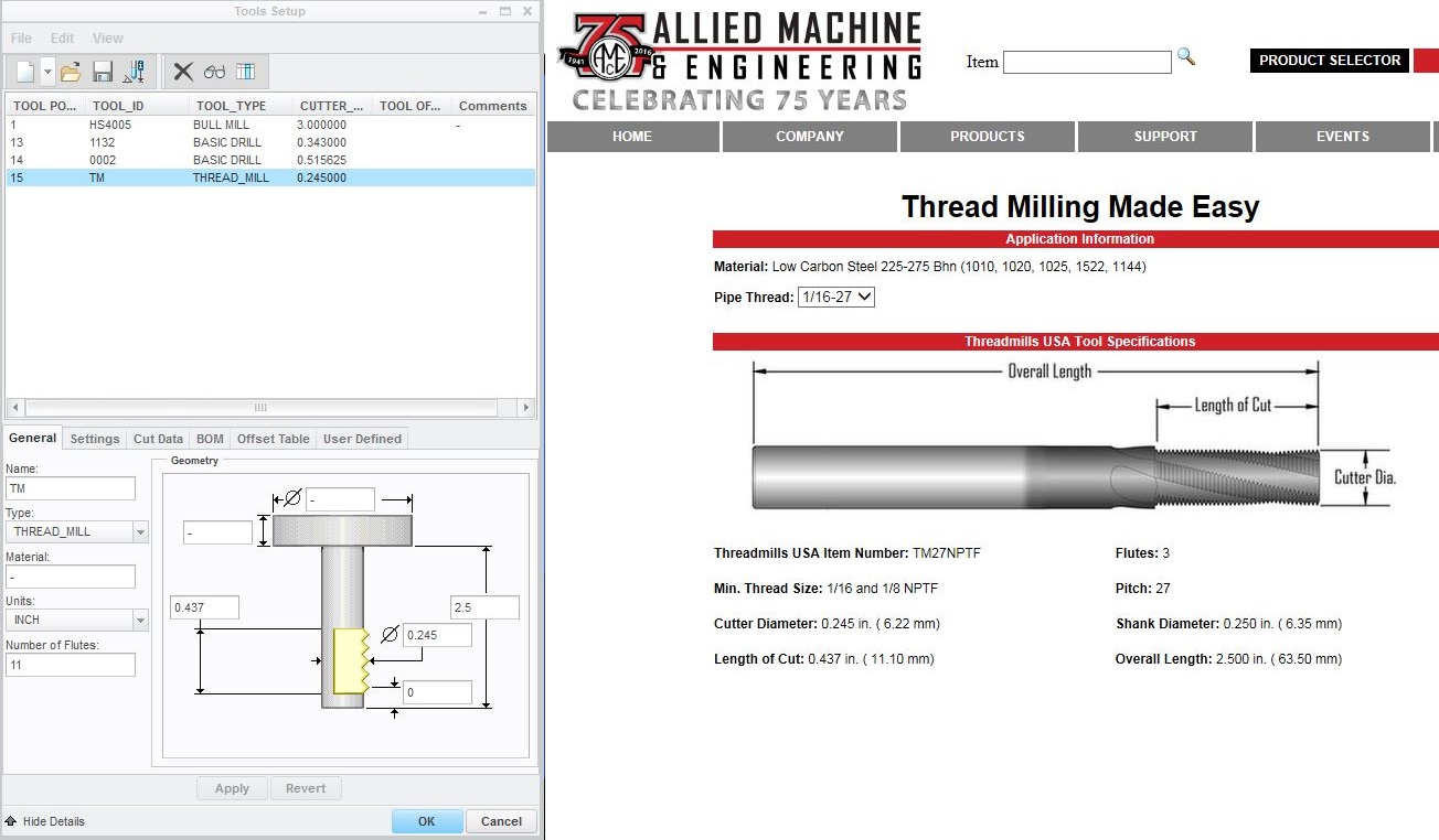

Here you can see my how my tool is defined, it is an Allied TM27NPTF in case anyone wants to spec it out further.

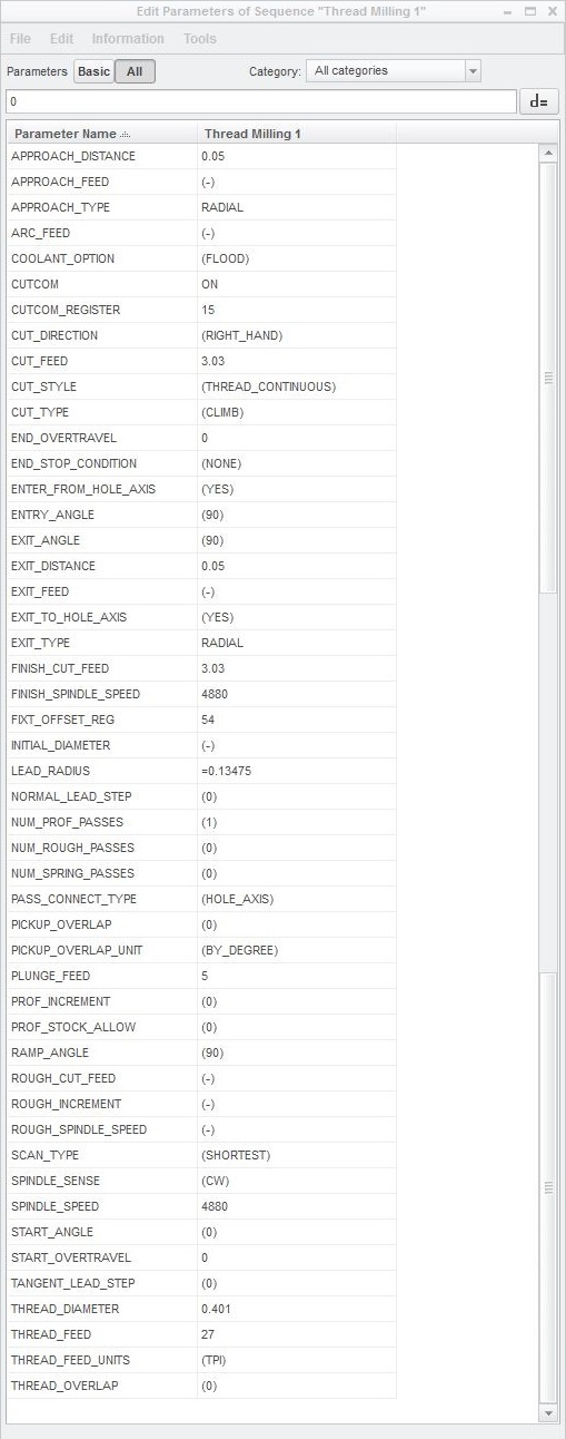

Here are my parameters

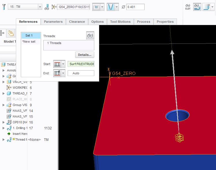

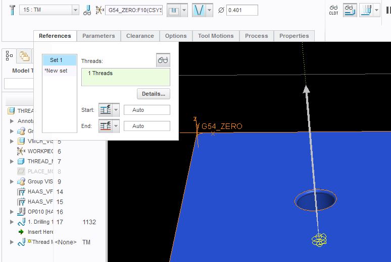

I want a normal NPT from the top of the part down, but here is the resulting tool paths that I get.   This is with start and end both set to "auto"
Here I selected the top of the part for start, and left the end as "auto", it gives me the same results as when both on auto.  Note that if I try to select the bottom of the part here as the start, and leave the end on "auto", it removes the tool path

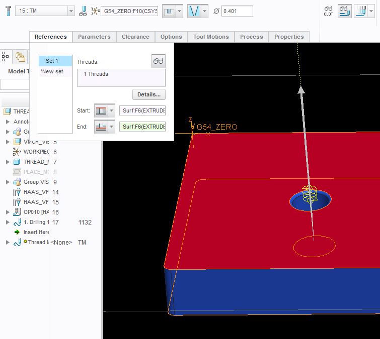

Here the start is still set to the top of the part, but now the end is set to the bottom of the part, yet the tool path is at the bottom and does not complete the thread to the top of the part.
This is the same as above, only reversed.  So the start is now set to the bottom of the part, and the end is set to the top of the part.  Now the tool path is to far above the part.

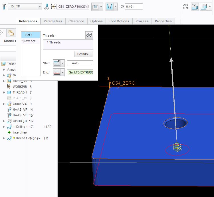

Lastly, we have the start set to auto, and the end set to the bottom of the part. Note that if I try to select the top of the part here as the end, and leave the start on "auto", it removes the tool path.
So aside of putting both start and end to the top of the part, or the bottom of the part simultaneously, I have now exhausted all possible combinations without achieving a normal NPT tool path.  I should also mention that I also tried calculating the NPT depth and creating a plane at that depth, setting the "end" to the plane I made, but it still did not make the desired tool path.

Question 1: Yes the number of teeth sets the depth it seems. I was confused by this at first also, but it seems to work.
Question 2: make sure your parameter Circ_interpolation is set to arc_only. this make far less lines of code than points_only.

Thanks for the quick response.  As for the "Circ_interpolation" parameter, I do not seem to have that parameter available, even when looking for it hidden under tools/visibility.  Any ideas?
Also for the NPT thread, I do understand that it starts at the bottom and threads itself up to the top, that is ok.  I will try to clarify, I was saying that I was unable to get the thread to end at the top of the part.  The thread seems to want to start from the very bottom surface of my part, and thread towards the top only a small distance, instead of starting somewhere in the middle of the hole, and threading fully up past the top of the part, if that makes any sense.

not sure why you are not seeing the circ_interpolation parameter?
if you are trying to spin the thread mill all the way out of the hole then you need to look at the over travel parameters. the start_overtravel makes the cutter go deeper into the hole and the end_overtravel makes the come out of the hole.
the last picture is a .600 deep thread with an end overtravel of.6  Hope this helps with what you are trying to do.
