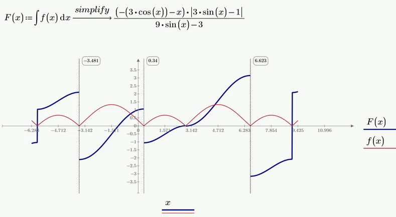

Bug report, symbolic engine in Prime 10, 9 returns wrong numeric result
The bug is present in Prime 10 and Prime 9 (can't test with P8 and P7).
Its not present in Prime 6 using the new engine!

Oct 12, 2024 11:44 AM UTC
I am sorry to see that Maple in MC11 is coming up with an incorrect result as well when the absolute value is used.
Reason seems to be that, while the symbolic evaluation of the indefinite integral is correct in all versions, all versions (including Prime 6, which so far is the only version which returns a correct result for the definite integral) return a function which is only piecewise continuous.
Therefore this integral function must not be used to calculated the definite integral the 'usual', simple way (which is was all versions except Prime 6 seem to do),
but instead has to consider the jumps at the discontinuities.
To get the correct result we could use
EDIT: SORRY!! The above was awfully wrong! The zero of f(x) is NOT at pi/9 but rather arcsin(1/3) of course!
F(x) is not defined at this position (division by zero, actually a form of 0/0) so we have to use the limes
Somehow Prime 6 is the only version where the symbolic version is able to return a correct result, even though its ugly looking
And of course once we know where the problem seems to be we an also split the integral accordingly o get the correct symbolic result
We get the same results in Prime if we rewrite the function using the square root of the square.
Reason seems to be that an internal simplification ends up at the absolute value again

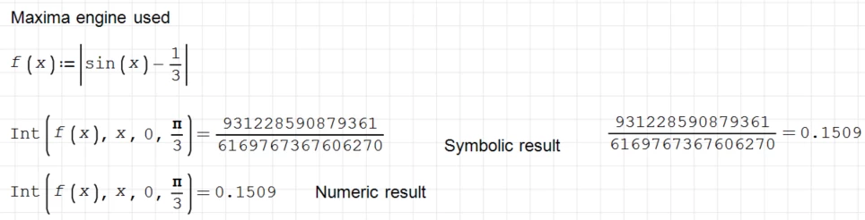

SMath Studio with Maxima engine used outputs these result of this integral:
Werner_E25-Diamond IAuthor
Oct 14, 2024 10:41 AM UTC
Thanks for trying.
Its disappointing that SMath returns a wrong result, too.

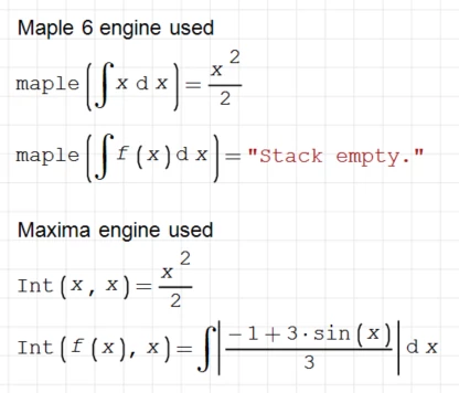

Oct 14, 2024 11:15 AM UTC
Both Maple version 6 and Maxima engines are not able to calculate this integral symbollicaly in SMath Studio:
