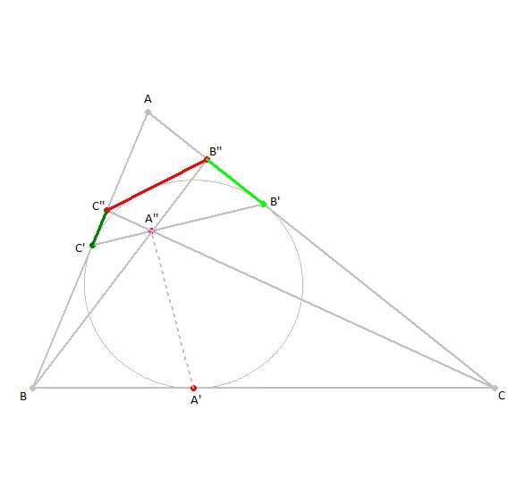

Hello, Everyone.
From the following :
Given :
Let ABC be a triangle with incircle ( I ), and let ( I ) touch BC, CA, AB at A', B', C', respectively.
Drop perpendicular from A' onto B'C' at A''. Lines BA'' and CA meet at B''. Lines CA'' and AB meet
at C''.
Prove :
C'C'' + B'B'' = C''B''
( dark-green + green = red )
    Thanks in advance for your time and help.
        Best Regards.
             Loi.

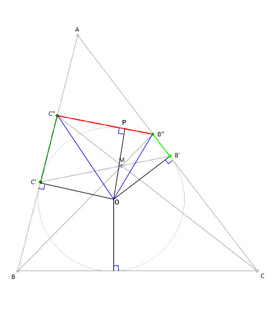

For my above picture, at first point P on the circle (1) is selected between circular arc c'Pb'.
Then make tangent line c"Pb" at point P on the circle. This is the red line.
Then
Make △OB"B'≡△OB"P and make △OC"C'≡△OC"P.
Length of OB'=OC'=OP=radius r of the circle.
Angle of ∠OB'B"=∠OPB"=∠OC'C"=∠OPC"=90 deg. (Because the tangent line must be perpendicular to radius r.)
So
If we can show the intersection point M of line cc" and bb" is also on the line c'b', it is solved.
t.t.

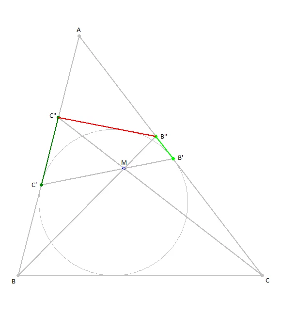

Actually it does not matter where you choose the point A'' on the line B'C' !
B''C'' will always be a tangent to the circle and so the two green lines will add up to the red one.

And the butterfly problem should be stated as the following:
     Let ABC be a triangle with incircle ( I ), and let ( I ) touch AC, AB at B', C', respectively. M is a
point on segment B'C'. Lines BM and CA meet at B''. Lines CM and AB meet at C''.
Prove :
C'C'' + B'B'' = C''B''.
    And I still got stuck proving B''C'' be a tangent to the incircle ( I ).
