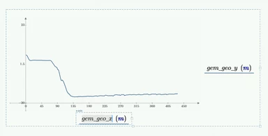

I have lots of datasets with different embankment profiles, see picture for example. Each embankment contains 1 or 2 slopes.
Is it possible to calculate the slope (in this case 2) within the profile. How do I select my boundaries for each slope on the x axis. I can connect my data trough excel as import or make x-y tables/matrixes in mathcad.

Let me try to clarify a little bit more and add a file with the data of the profile.
In the profile you can see 2 slopes
-1 small one in between 2-12
-2 and a large one in between 72-130.
I would like to calclate the slope of both. I started out with 1. Can mathcad predict the begin and endpoints of slope locations if the data would change a little and what happens if there is like a gap in my data(or is this going to be user input in my sheet). The data in this case is a geometric profile of an embankment.

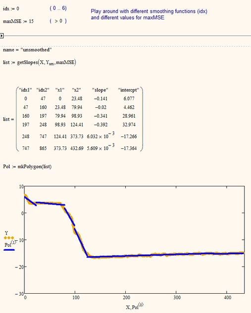

Here are some attempts to automate the finding of the segments with a higher (speaking of the absolute value) slope than a given threshold which does not use an interpolating function and its derivative.
The first approach would need a different kind of smoothing function, I guess
The second approach might be useful. You may have to play around with the parameters and I can't tell if one set of  parameters would be appropriate for all your data sets - you had just provided one.
The sheet was created in Mathcad 15 (what else) and I attach the original MC 15 sheet along with a pdf print as well as a converted Prime 4.0 sheet.
Guess there sure are people out there able to provide a file converted to Prime 3.0 if necessary.

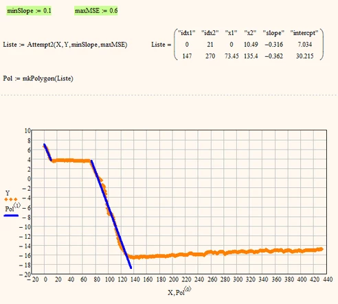

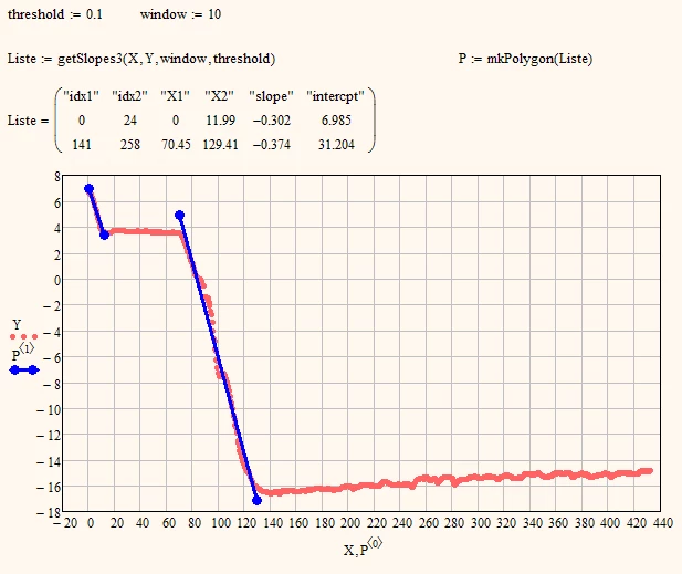

January 26, 2018
Here are two more attempts, using a numeric discrete derivative but again no interpolating function.
You'll have to give it a try with some others of your data sets.
Sorry, can't attach a Prime 3.0 sheet at the moment. If you ask I am sure someone will be able to convert the MC15 file to Prime 3.
