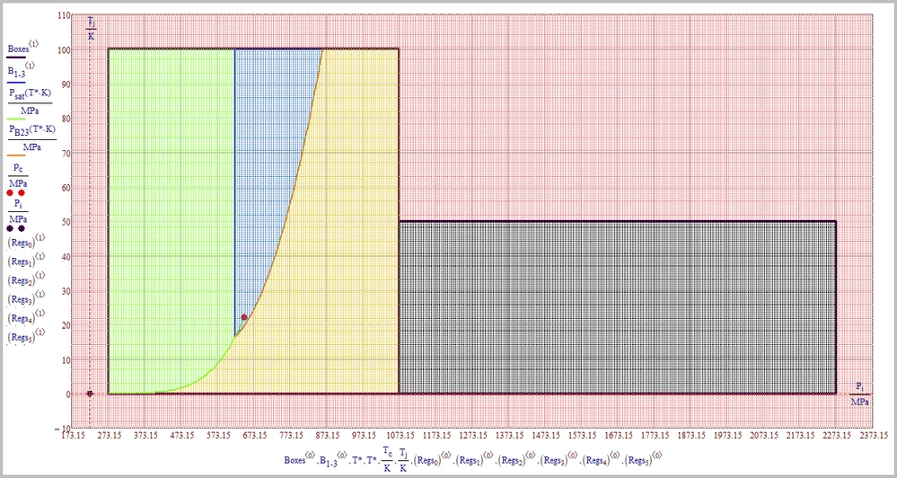

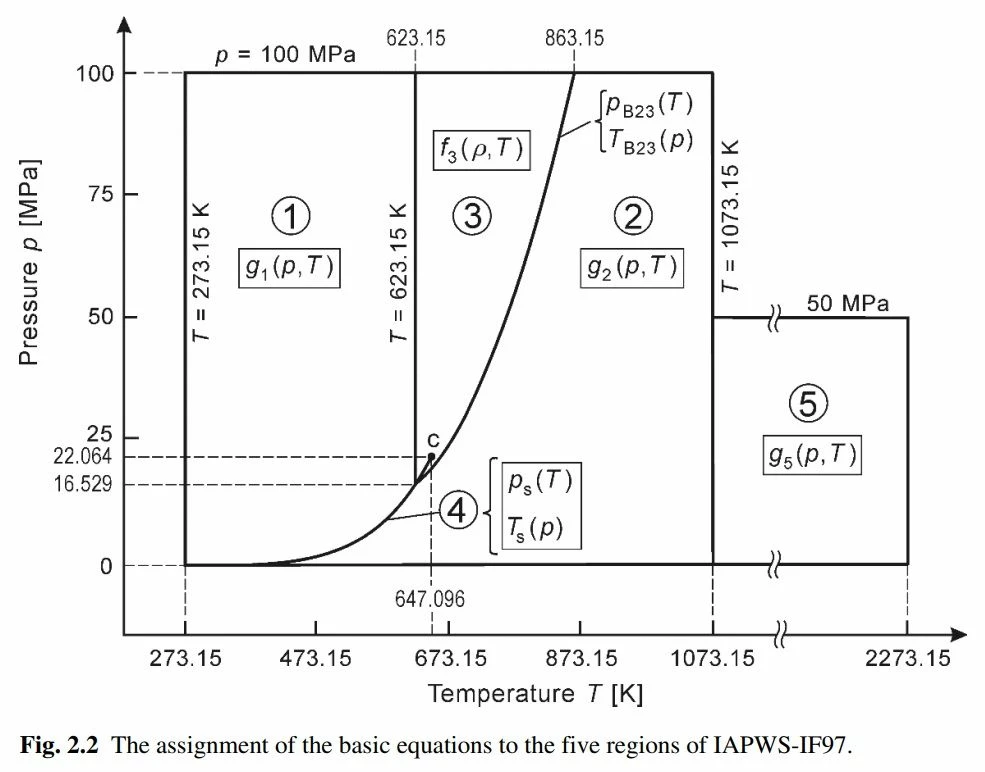

In this case, I need to determine in which region of IAPWS-IF97 (formulation for thermodynamic properties of water) the point lies on a pressure-temperature plot.
P-T Diagram, Validity range of IF-97P-T Diagram, Validity range of IF-97

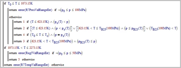

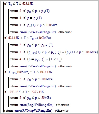

So, here is the question itself: wich model of (p,T) function would be faster and easier to calculate (e.g. on a low-spec hardware), the one with separated IF`s, or the one where IF`s combined with usage of multiple "and (˄)" and "or (˅)"?
And will the result be different in Mathcad Prime?
Model 1
Model 2

Turn both calculations into functions of T, p  and perform timing tests (use the time(0) function) by calling each function multiple times using a series of predefined values of T, p or random created values.
What I notice is that your three functions p.s(T), p.B23(T) and T.B23(100MPa) are called multiple times and it may be beneficial if you calculate the values only once and assign the result variables which then are used in the comparisons. Especially T.B23(100MPa) is a constant value independent from T and so could be precalculated in front of the function in the worksheet.
Are you sure about the "AND" here? Shouldn't it rather be an "OR" ??
I am not sure if it would speed up the evaluation but you could omit the lower limit in all your comparisons. Just use if T<b instead of if a<T<b.
But you will have to add an additional "if T<To then return errormessage" at the front which may eat up the gain of speed by not having to check the lower bounds, You'll have to experiment with this.

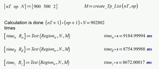

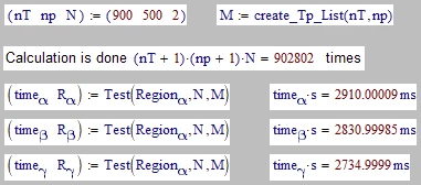

Hi Werner,
Sorry for delayed reply, had stuff to do.
Thank you for pointing out onto this time() function, didnt know about the existence of such.
I used it to test out my functions, file attached.

Yes, agree with you, so I cloned the 1st model with the applied modification and also tested it out.
In the end, the first model (untouched) is labeled α, its modified version - β, and the original second model is γ.

Jan 31, 2026 1:39 AM UTC

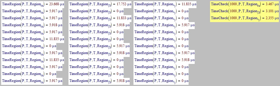

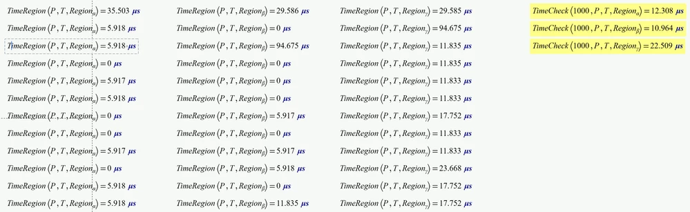

Here are the results of your timing tests on my (slow) machine.
I also added a test using slightly less than 1 Million evenly distributed in the whole area visible in your plot. Time shown is the total calc time, not divided by the number of points checked.
I would say that even though the third approach is slightly faster (in this run, pressing Ctrl-F9 you might see another 'winner') they all are equally well.
I converted the sheet to Prime 11.0.0.0 and recalculated it. Of course multithreading was turned off as otherwise timing would not work.
Here are the disappointing results running on the very same machine:
Just for fun I added the points differently colored to your plot (its no surprise that none of them is in 'region' 4). So there is a visual check for plausibility of the region test function(s).
I attach my modified MC15 sheet and also for whatever it may be worth the converted P11 sheet. The latter is quite a mess and the plots fail. I made no attempts to clean up or fix.

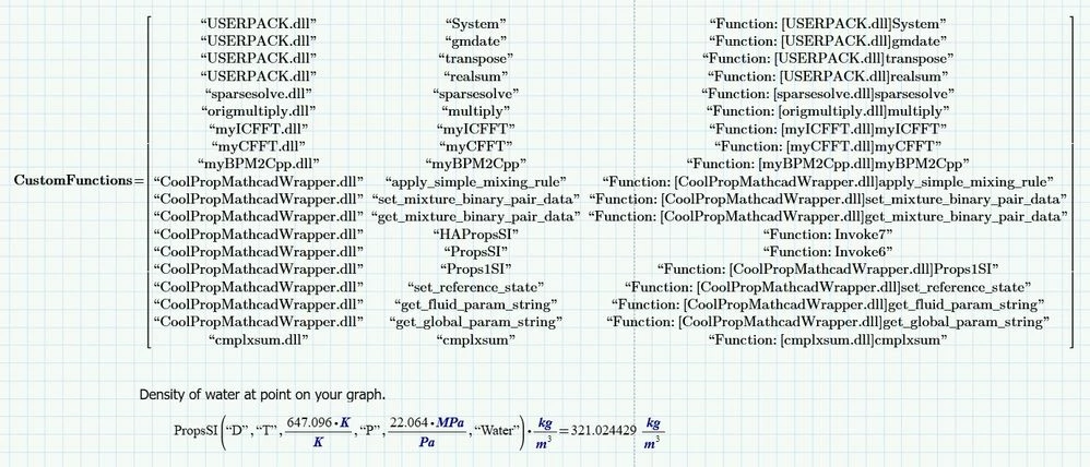

Have you looked at the CoolProp wrapper for Prime.
https://coolprop.org/ for documentation
It complies with IAPWS-IF97
It looks like you are reinventing the wheel.  Web site to download two files
https://sourceforge.net/projects/coolprop/files/CoolProp/7.2.0/MathcadPrime/
CoolProp is compiled code so will run far faster than Primes interpreted programming.
The web site has two files, a Prime worksheet with examples, and a DLL file
Just put the DLL in C:\Program Files\PTC\Mathcad Prime 11.0.0.0\Custom Functions and hey presto you can use the functions.
After you put the DLL in the folder restart Prime to register it
Worksheet from the web has examples
They are fast

Jan 30, 2026 4:25 PM UTC
Looked into it a bit deeper and you need to specify IF97 like this
Cheers
