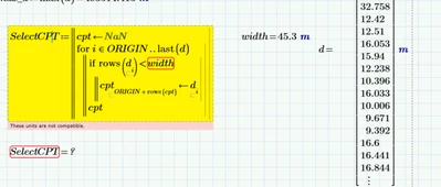

Hi there
I want to exclude some values from d when it is bigger than the width .... I want the program to just exclude the values that do not fulfil the condition, I used this program ,but it shows strange error ...I'm sure both of them have the same units
How to fix this ?

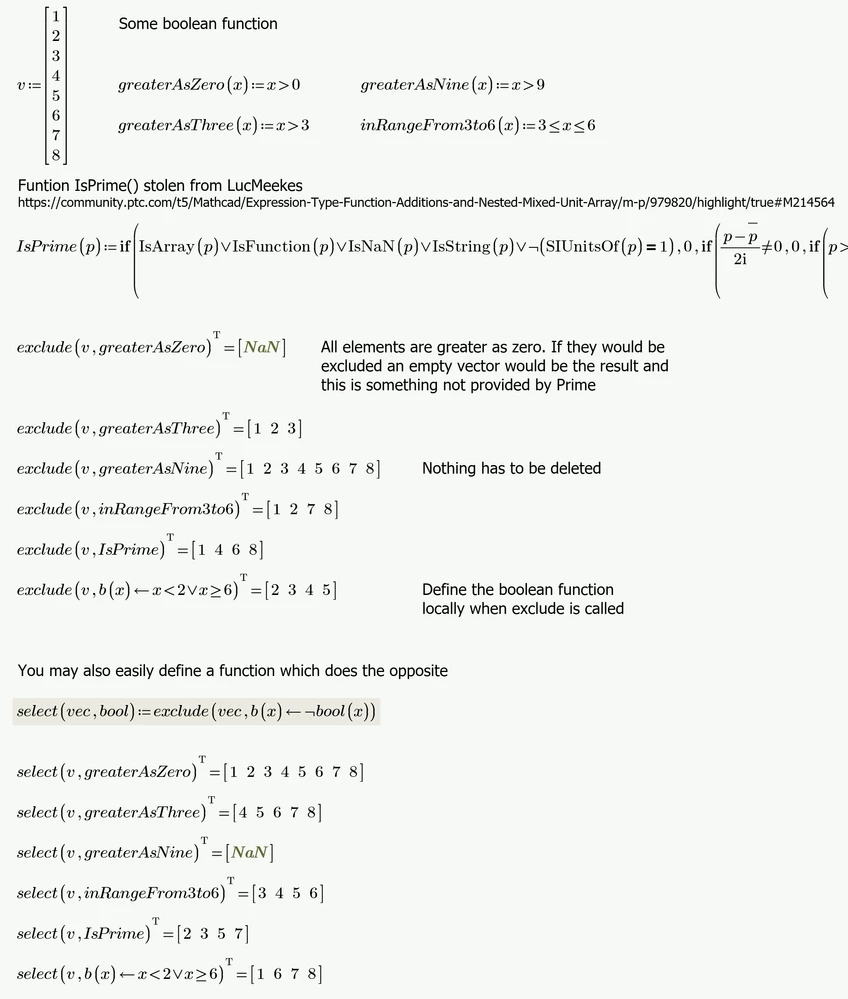

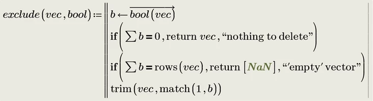

You may also use a generic utility function to do the job:
You may then use either
or in one go
You have to decide what to return in case all elements have to be deleted. As Prime does not provide an empty array you may chose 0 or NaN or, like I did, a 1x1 array containing NaN (so I can still use the transpose operator even in that case).
Here some examples of usage

Delete the word "rows", just use     if d[i < width
A simpler way probably would be to just use
or
Caution: This will fail, if ALL values in d are smaller than width or if ALL are larger or equal.
EDIT: See a more generic function which also deals with these special cases in my answer below.
or in one go

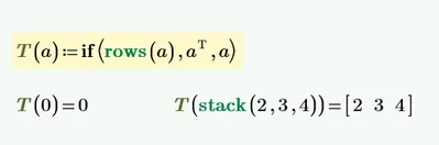

Neat.
My preference is to return 0, as that way, it is clear that the result is not a vector and can be conveniently tested using a boolean. In addition, there are cases where [NaN] might be a valid (vector) result.
To deal with the transpose problem, I use a nifty transpose function, usually defined as T (in Constant Math Style), which transposes array inputs but leaves scalars alone.
I sometimes also use it (or suitable variants) under vectorization.  I have other variants for dealing with nested vectors when the display gets too tall or difficult to interpret.
Oddly, I also find it more keyboard-friendly, as typing "shift-T shift-9" comes to my fingers more readily than positioning the cursor where needed and typing "ctrl-shift-t," probably because it requires less hand movement.
