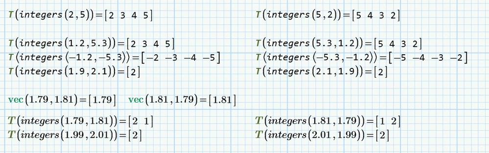

Once upon a time, when a whiteboard was bitten by a radioactive spider and mutated into Mathcad, I wrote several sequence generation functions.
One of these functions was integers(a,b), which, given integers a and b, generated a list of consecutive integers between a and b, inclusive.
Whilst updating my library of such functions to Mathcad Prime 11, I was emboldened by the idea of handling real a and b.  Now, I could have gone the restrictive route and treated non-integer arguments as errors, but I decided to go with the flow and see if I could give some meaning to real inputs.
All went swimmingly in my imagination - just restrict the output of the function to those integers lying between a and b.  Until I thought about it for a few moments and realised that wouldn't work for certain cases - see the bottom of the screenshot below.
Any ideas for how integers should handle such cases to give "meaningful" results?  Or am I on a fool's errand?
(The algorithm doesn't matter, merely the behaviour)

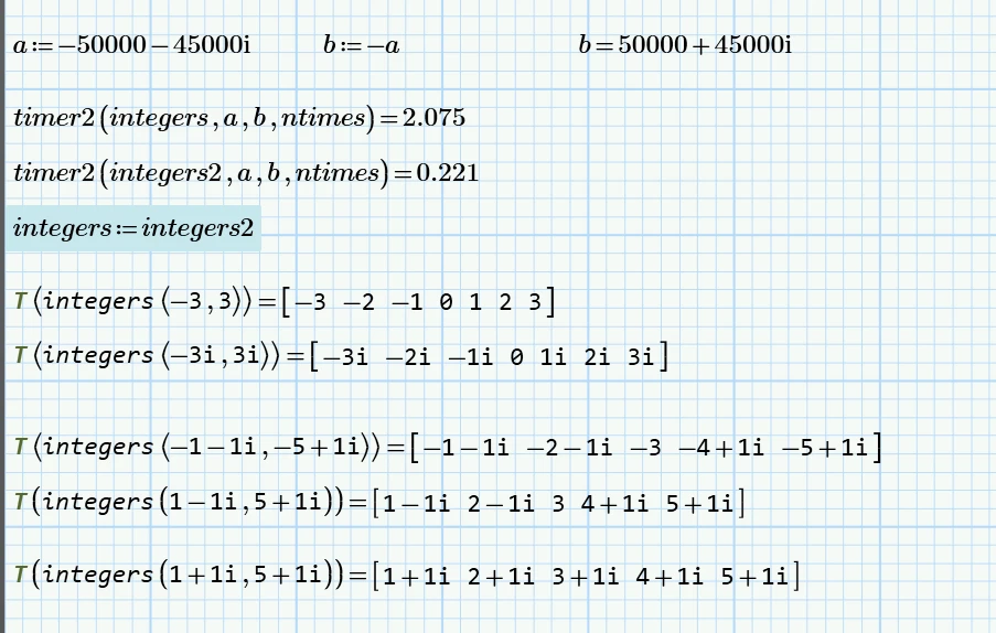

Oh, and, yes, integers covers the Gaussian integers.  The image below shows the performance change from using a Bresenham algorithm (integers) to using vec (integers2) to generate a sequence.

September 12, 2025
I would suggest that you get PTC to finally implement empty array and then return it this case there is no integer within the given limits. May take some time as they first will implement multidimensional arrays 😈
In the meantime, the function maybe could return NaN or [NaN].
Yes, that's the conclusion I'd regretfully decided was the most sensible option.  I use 0 (zero) as the empty array substitute because it's easier to test for (and was what I used before the introduction of NaN, so I'd have to rewrite quite a few library functions to achieve consistency).
