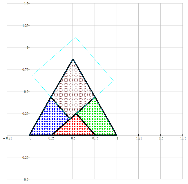

Its the 123 year old Haberdasher problem, posed originally by the famous puzzle inventor Henry Dudeney. Actually there are various different publishing dates around - 1902, 1903, 1907 ...
The task is to divide an equilateral triangle of side length 1 with three straight, but not necessarily continuous, cuts into four parts so that they can then be put together to form a square.
Dudeney provided the solution only in the form of a drawing, but without specifying the exact dimensions.
Let D and E be the midpoints of AC and AB. The first cut runs from E to a point F on AB.
The other two cuts run from D and G perpedicular to EF. G is a point an AB and it can easily be seen that AG = AF+0.5 (or equivalent GB = 0.5-AF).

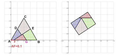

The four pieces now can be assembled to form a rectangle:

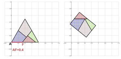

Depending on the choice of F, different rectangles may result.
The task now is to determine the value for AF so that the rectangle is a perfect square:
There are solutions around where AF=0.25 which actually is a good approximation, but the rectangle formed that way IS NOT a perfect square.
The correct value for AF is slightly larger, about 0.2545076167.

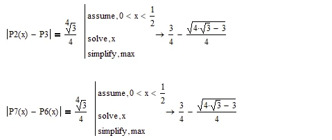

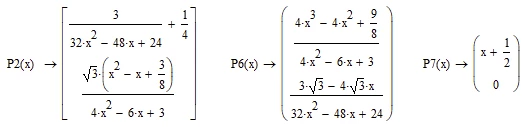

My calculation expressed the coordinates of all points that are not fixed as a function of AF and then calculated the value of AF for which the lengths of the two smaller cut lines, which are perpendicular to the first cut EF, are exactly half the side of the square. The side of the square can easily be specified because of the equality of area of the triangle and the square.
Here is the corresponding part from the calculation (the sheet is otherwise quite a mess 😉 ). The identifiers are different from the ones I gave in the drawing above.
x = AF, P3 = D and P7 = G.
We could do the calculations by hand but with point coordinates like
its was quite convenient to have Mathcad at hand 🙂
