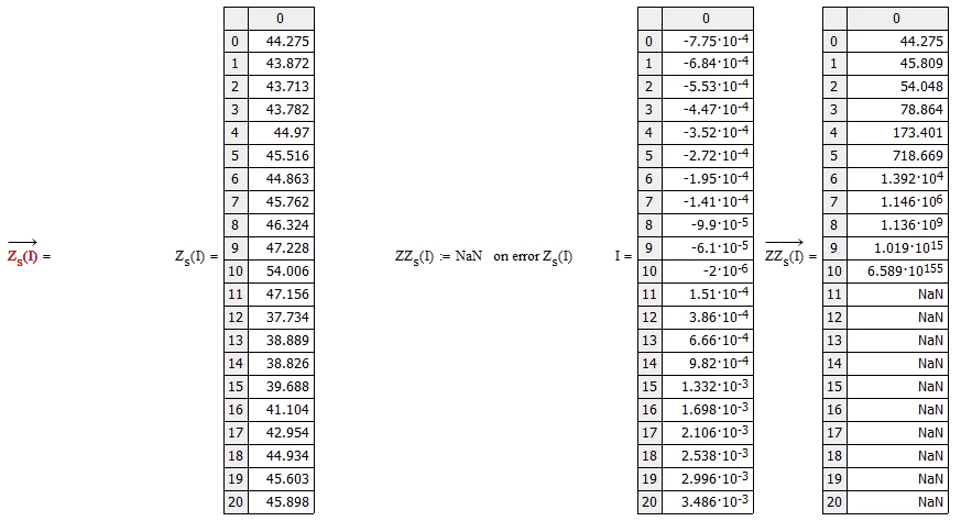

One possible way is to make the Integral function dependent on the index k
But your function Z.s returns far too high values for I > -2*10^-6 and so the integral will fail.
Note thats it a big difference if you call Z.s(I) vectorized or not vectorized.
I used "on error" to show where Z.s(I) fails:
Is this due to the bad fit of the data?
Z.s(I) looks almost like a constant number, not big variations. In more simpler calculations it is even taken as a constant as a formula for Ohms law V=R*I.

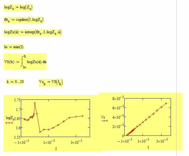

Do you want something more like this:
Alan
Yes, this I wanted. Except Io there must be 0.
Why?  If you aren't interested in values of I that are less than zero it would be best to remove them (and the corresponding values of Z) from the start.
Incidentally, in my solution I integrated logZs. If you actually want the integral of the values of Zs,  you will need to set  Zs = 10^(logZs) first.
