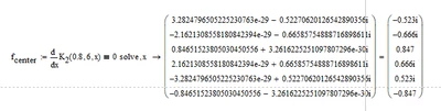

Hi experts,
I would like to know how to only get one value from my answer.
I mean I only need 0.847, but there are 6 answers in there. does anyone know how to do it.

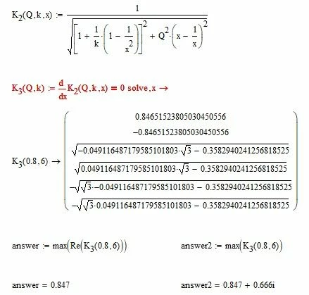

OK. here are two possible solutions to the problem and personally I don't like any of the two.
The first one is based on a strange difference in behaviour between "Lookup" and "Hlookup". I have no idea why "Lookup" returns the non-real values with a positive real part as well, but "Hlookup" only returns the real values.
I don't know if its a bug or if there is a special reason for this difference. But we can take advantage of it and use "Hlookup" to get the largest real solution (and hope that its a positive value, too 😉
Another approach uses the "max" function along with a vectorized evaluation. Because the result vector has to be used twice in this approach and I don't want to call K.3 two times, the function result is stored in a local variable "_X_".
The comparison for "approximate zero" with |....|<10^-8 was necessary because of numerical inaccuracies the real solutions sometimes come along with a very tiny imaginary part.

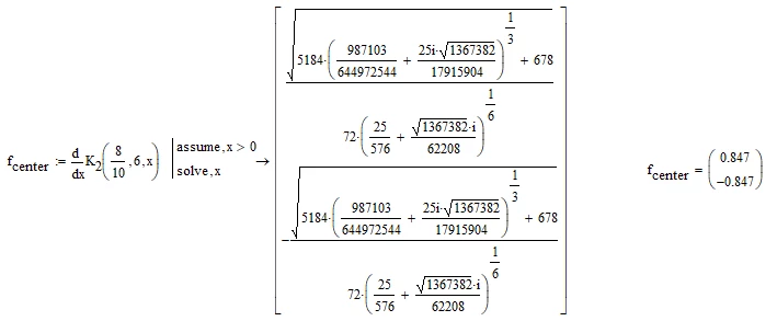

You may try the modifier "assume" to narrow down the solutions you get. I guess that you are interested in the positive solution only, so you may try "assume,x>0".
Unfortunately the symbolics quite often ignores the"assume" modifier.

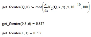

You may also consider using one of the two numeric methods. Either a solve block with "find" or one of the two flavors of the "root" function.
Here you can provide an appropriate guess value, add a constraint or provide a range (e.g. from 0 to 5) where Mathcad should look for a solution.

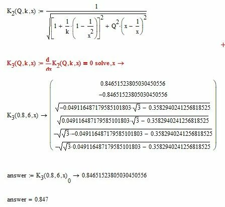

Simply index the required single answer.

Normally an "assume, x>0" should do the job, but as already written, the symbolics in Mathcad is in no way perfect and ever so often ignores an assume modifier or interprets it not exactly the way we would like it to do.
In your case for some reason we get both real solutions
In case you use the symbolic "solve" on purpose and need the exact expression - you get them if you avoid floating point numbers
If you can't say which element in the result vector is the positive, real value (I guess real and positive are the properties you are interested in), you may let ;Mathcad find the appropriate value for you.
Note the capital "L" in "Lookup" and make "ORIGIN" a vector/matrix index (you may replace it by 0 (zero) if you use Mathcads default values).
But I still think that a pure numeric approach might be more appropriate. See an example here
