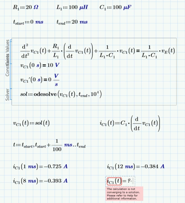

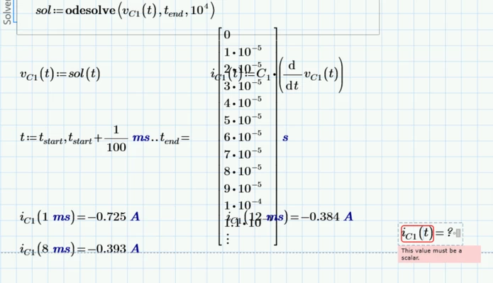

How to show all the values of ic1(t). If I put iC1(1ms) for example the calculation is done, but I want to have a vector of all the values of iC1(t). Is it possible?

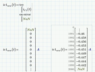

Here you are:
As you can see the evaluation fails for the first and the last value of t.
You are using numerical differentiation for a function derived with "odesolve" for arguments from 0s to t.end
The algorithm used by Prime for this seems to use the function values ​​of arguments before and after the point in question. But in the result of a 'function' determined by "odesolve" there are no function values ​​for arguments before the first initial value of t (0 s) or after the last value (t.end). So the numerical derivative can't be calculated for these end values.
The evaluation should be possible without this problem using the function i.C1(t), which, as I have shown, is determined together with the others in the solution block.

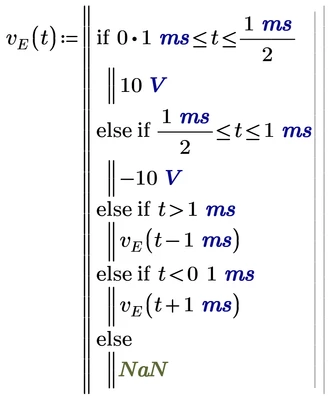

I would like to complete this task in the classic way. To do this, I need the function n vE(t) so that I can use it in MC14. There is a sentimental reason for my request: I remember my student days when easy exercises of this kind were stressful.
Jun 1, 2024 7:48 AM UTC
vE(t) is a simple square wave signal
similar to the one posted here  Why these 2 function implementation of square wave...
You also may use one of the alternatives I provided there (Tf = 1 ms,  Vmax = 10 V) or if its more convenient for you, you may also use a definition using the Heaviside function:
But I guess that the periodic nature of the function vE will make deriving a closed form symbolic solution using the "classic way' to solve this 'easy exercise' somewhat difficult.
