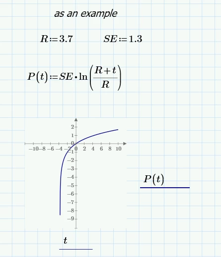

 how to write this variable in PTC Mathcad prime?
18 replies
Screenshot_1.pngas an example

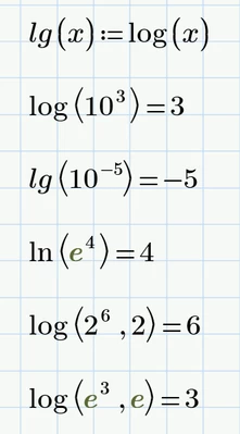

In Prime, log(x) alone stands for the decimal logarithm – unfortunately, because this does not comply with the standard and should actually be lg(x). Of course, you could also define the function yourself -> lg(x):=log(x)
In other programs, log(x) often stands for the natural logarithm, which is no better, because it should be denoted by ln(x).
Prime supports ln(x) but also logarithms to any base, because the log function can also be used with a second function argument, the logarithm base.
So you could also write the natural logarithm as log(x,e), analogous to the general notation in your image. But why would you do that when you have the ln function ready to use?

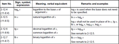

But as an engineer in particular, you should be used to adhering strictly to standards, right?
Luc was faster to post the ISO 80000-2 standard dealing with logarithm.

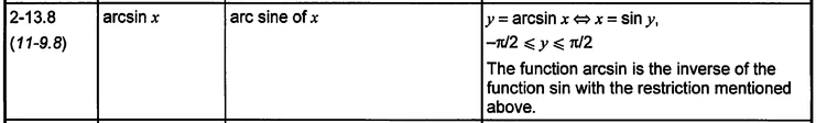

Nor do pocket calculators adhere to the standard. Here "log" usually means the base-10-log and instead of "arcsin" etc. the key is labeled with sin-1 which is quite common use but also does not conform to the standard. Actually sin-1(x) should be interpreted as 1/sin(x), i.e., as a reciprocal value and not as an inverse function. Similar to sin² x = (sin(x))².

This is what the internation standard (ISO 80000-2) states about notation of logarithms:
