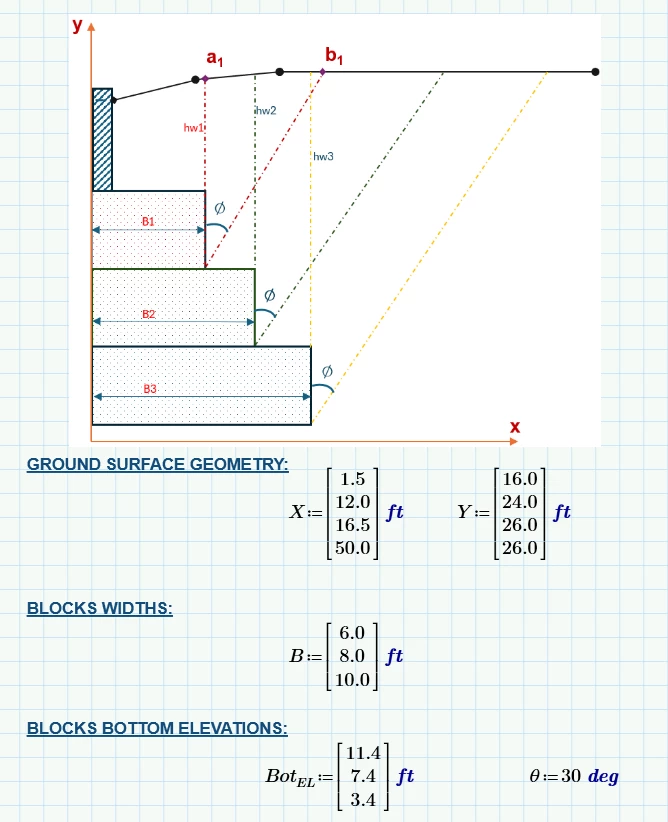

I have three stacked blocks with widths denoted as B1, B2, and B3. Each block is 4 feet high, and the bottom elevation of the lowest block is defined by BotEL.
The ground surface is represented by a set of known points with X and Y coordinates describing its sloping geometry.
For each block, I need to determine the coordinates of two intersection points with the ground surface. These are labeled a1 and b1 for the first block, a2 and b2 for the second, and so on.
The "a" points correspond to the vertical lines at the right edge of each block, where the X-coordinate aligns with the block’s right edge. The corresponding Y-coordinate must be interpolated from the ground profile at that X-location, The "b" points correspond to lines forming an angle θ (theta) with the ground as shown. A Mathcad and an image illustrating the problem are attached.

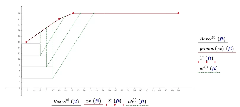

Here you are
9 replies
Something like this?
Note that in the sheet I could not use the "linterp" function because I am limited to Prime Express. In the full version you should delete my workaround and enable the region using "linterp".
Prime 10 sheet attached
For future questions you should say which version of Prime you are using. Otherwise you might get the answer in a the format of a newer version which you would not be able to read.
Thank you very much, @Werner_E, for the excellent response. The good news is that I’m also using Prime 10, I’ll definitely keep your reminder in mind for the future.
I followed your instructions and made a few minor adjustments, such as setting the ORIGIN to 1 and combining the X and Y inputs into a single matrix (attached). Fortunately, everything is still working perfectly! I’m learning a lot from your code, thank you!
