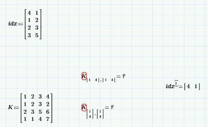

So far I guess the following should help. You can extract the appropriate row of your idx matrix using Primes row selector.

Say I want to extract row and column 1 and 4 from K,
You are not just looking for the extraction of a single matrix element, or are you?
Or do you really mean what you write - extracting the full first and fourth column and also the first and fourth row. This would mean that in your example you want to extract 16 values and four of them would be extracted twice. If that is what you are after, you would have to tell us in which way you would like the 16 (or 12) value being arranged - which data structure.

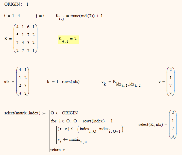

In case you are looking for a way to extract a couple of matrix elements whose indices are given by a matrix "idx" and collect those elements in a vector, the following two methods should help. Otherwise you would have to come back and specify more detailed what kind of result you are expecting.
BTW, the value 5 in your idx matrix seems to be wrong anyway, even if you set ORIGIN to 1.

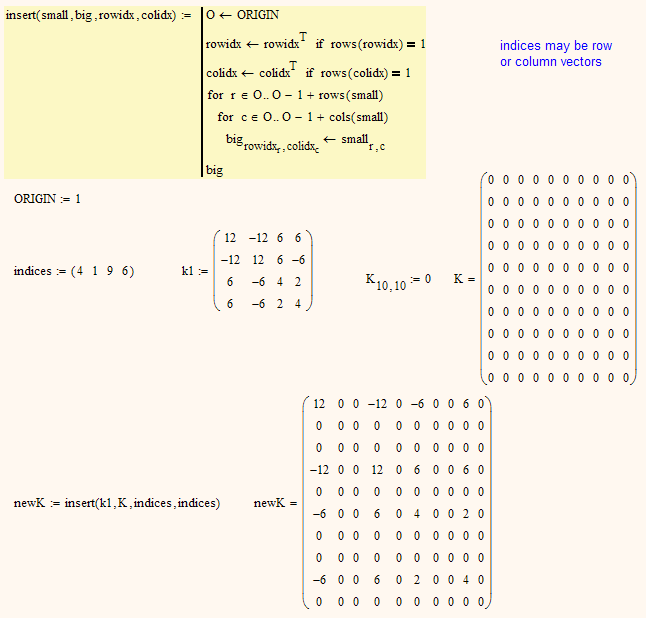

‌5 would be wrong as an index into K as given; however, the example he gives is the Cartesian product of the first row of idx (that is, combinations of 4 and 1), so Matlab will return a 2x2 array of those elements.  I've got a few functions that will do vaguely what he wants ... I'll dig them out tomorrow when I've got access to the PC I've got them on.I
