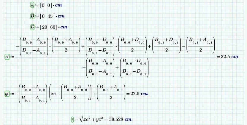

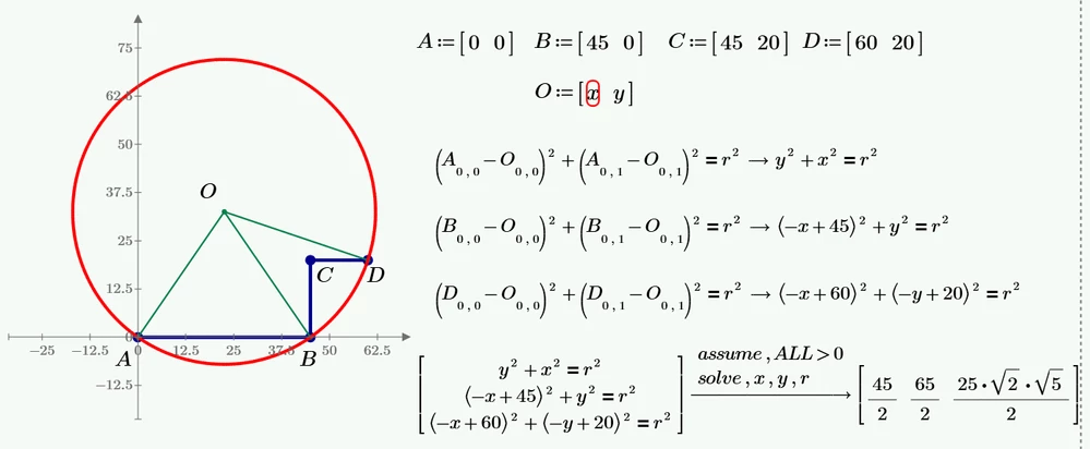

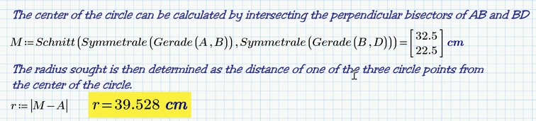

Intersection of perpendicular bisectors of AB and BD meet at the center.  Once have center can get radius center to A.
As you posted a file in Prime Express 4.0 format, I thought I would provide an Express solution as well.
Basically simply two perpendicular bisectors are intersected to get the center M of the circle and the radius is the distance of M to one of the three circle points A, B or D.
Prime Express 4 file attached

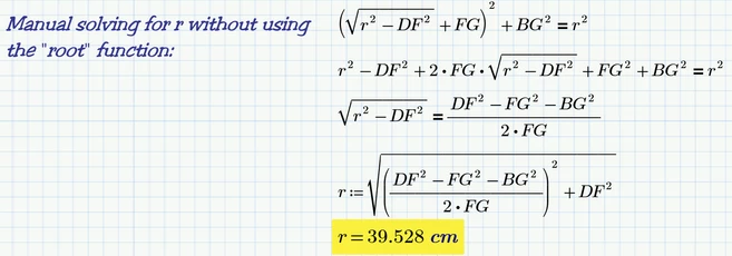

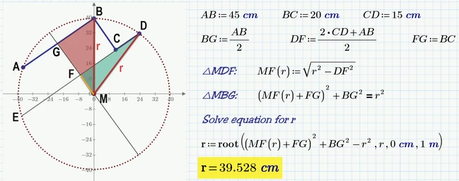

Here a more basic approach without analytical geometry, just using good old Pythagoras.
The solving of a system of equations (in r and MF) is somewhat hidden by  first expressing MF with r and putting that expression in the second equation.
"root" function can be avoided by some manual term manipulations

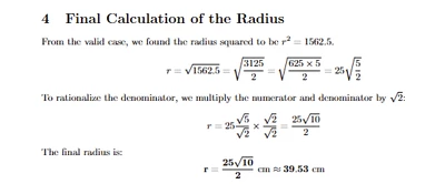

Since this was for fun I thought I'd see if I could replace Mathcad with Gemini Ai.
I have a circle. I draw a chord AB =45cm. Then I draw a line at 90 degrees to AB =20cm. This line is inside the circle. I draw another line perpendicular to  AC towards the circumference. This line is CD =15cm and terminates on the circumference of the circle. Determine the radius.

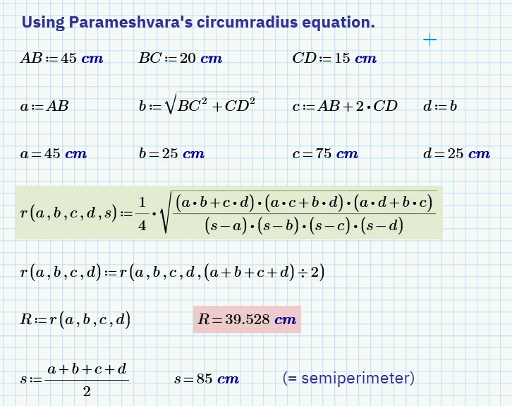

I was going to go Werner's "good old Pythagoras" route until I saw he'd already posted it.   So, as we've had Greeks, I'll go Indian instead.
18-Opal
Well they are both Indian.
The Baudhayana Shulba Sutra, an Indian text written between the 8th and 5th century BC, contains a statement of the theorem, a specific case for the isosceles right triangle, and the general case. This predates Pythagoras by about 300 years.

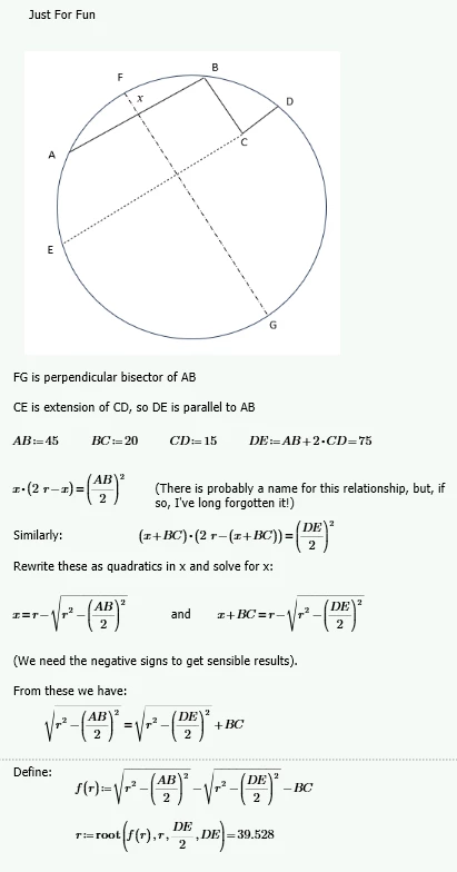

Here's another approach (Prime 11 Express):
Alan
It's nice to see so many ways to skin this cat!
> (There is probably a name for this relationship, but, if so, I've long forgotten it!)
In German it's called "Höhensatz". According to Wikipedia its called "Geometric Mean Theorem" in English -> Geometric mean theorem - Wikipedia
