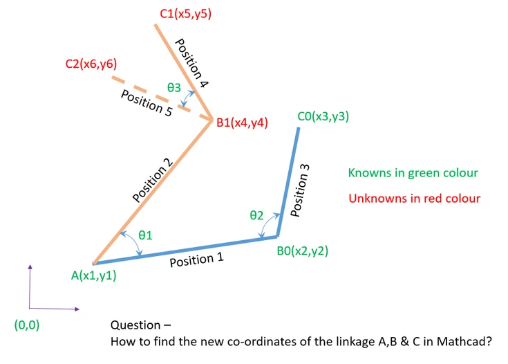

Dear Mathcad veterans,
I'm doing a linkage calculation / kinematics calculation using co-ordinates (x,y), for which I would like to know the methods of finding co-ordinate's new location (marked as position 2, 4 and 5 in the below representation. Please share your views or directions or solutions.

How does your question relate to Mathcad or Prime?
You have three different points all named C1 !?
Obviously you are just dealing with simple rotations.
The fist of the C1 can be obtained by rotation C0 around the known B0 for an angle theta2.
You may model this by a system of two equations or by a multiplication with a rotational matrix. The necessary mathematics should be known or can be looked up.
Equally the other points C1 can be obtained by simply rotating the first C1 and also C0 around point A for angle theta.1 - same math as before! Also B1 is obtained from B0 by the very same rotation.

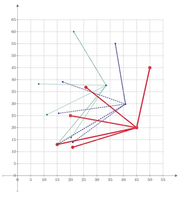

BTW, I see that you tried to plot the points. But I guess plotting all positions for all combination of angles could get quite confusing:

How to find A, B and C??
Guess you mean B1, C1 and C2, correct?
And I also guess that not only the"greens" are known but also the "browns", the three lengths which you named "Position" 2, 4 & 5.
Assuming this we could easily calculate B1, but C1 and C2 can not be determined with he given values. Additional information would be necessary, e.g. he angle between Position 2 and either Pos.4 or Pos.5.
Also theta2 is overdetermined and should be omitted, because the angle can already be calculated from the other pieces of information!

Jul 6, 2023 5:39 AM UTC
Dear Werner,
I'm glad about your immediate response and great details.
Reading your reply, I realized my question and the representation of my question needs refinement which I did in the below image. Also please find the mathcad worksheet with inputs. Hoping to get solutions / views / methods / directions / relevant reference calculations.
