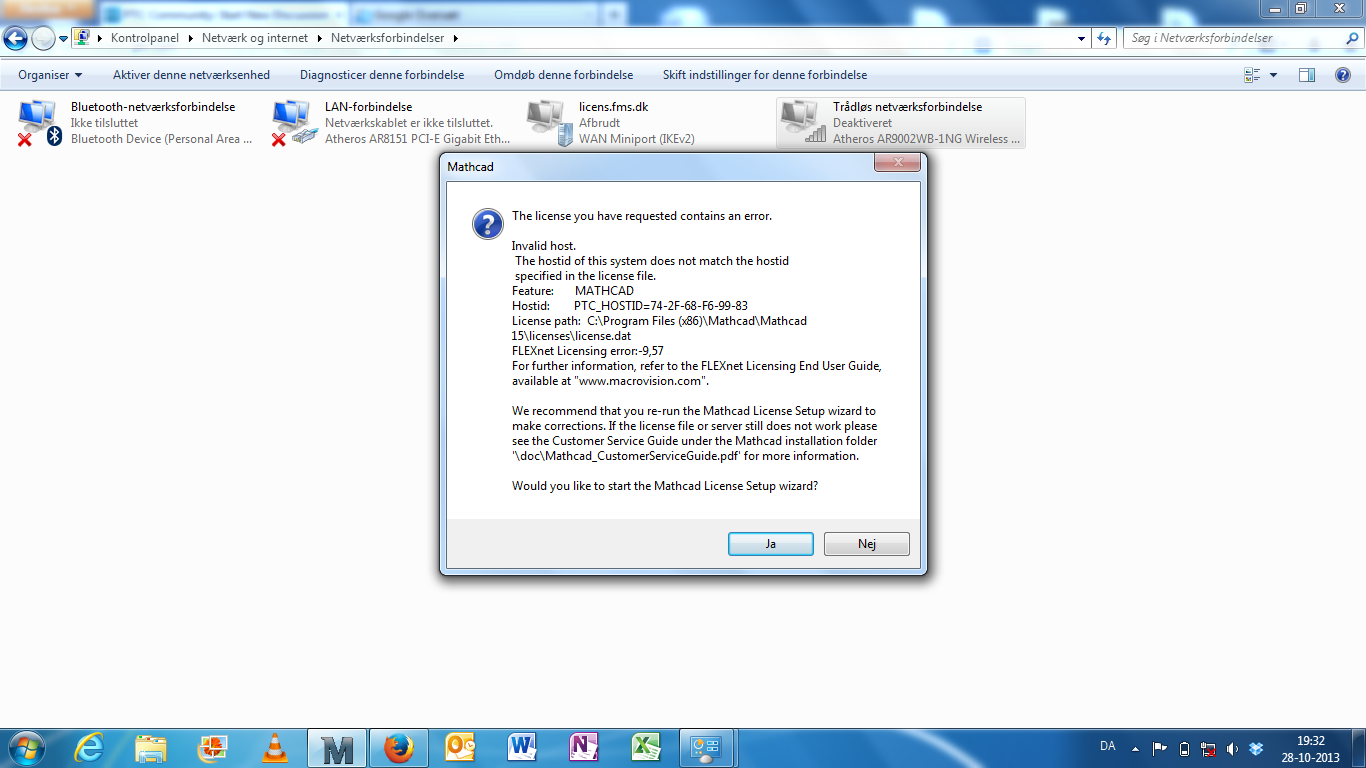

Using a new license did not solve my problem, it still takes 5-6 minutes to start up mathcad - but now when deactivating my wireless internet card i get this message:
I would think that mathcad is a program, independent off the internet?? I might be wrong after all??

The Mathcad license is bound to the MAC address of one of yor network interface cards (NICs). During installation Mathcad checks all NICs present and choses one (don't ask me how, I don't know) to be the "primary" NIC and requests a license file for that MAC address of this NIC from the PTC license server which is copied to your machine. When you start Mathcad it will read the license file and looks, if a NIC with the specified MAC address is present or throw the error message you showed otherwise. So Mathcad won't use the NIC to connect to the net (unless you have to use a floating license from a license server).
It looks like you had your wireless card activated during installation and Mathcad decided this to be the primary card. So when you deactivate the card - no Mathcad.
Do you have a NIC for cable in your machine and have the possibility to connect via cable during installation? Then you can try to get a new license file while you deactivate the WiFi Card. Probably you will need a new product code from your IT manager to be able to do so. You may also consider contacting PTC support and requesting a license file for the MAC of your cable bound NIC, but this can get rather tedious.

OKAY, this is strange!!!
I went back to my old key. Which did not have any effect.. So i tried something else - changing from dynamic IP-adress, I changed it to static, and with the IP-adress I have on the school..
This resulted in mathcad starting up after 30 sec... But still, it freezes using ctrl. + c and my internet is not connected.
I have no clue of what's going on!

Can you see if the old license is bound to the same MAC as the new one or, as I understood, to another one (the cabled one).
slaigaard1-VisitorAuthor
October 28, 2013
Hmm, if I deactivate the NIC again, and start up mathcad now, i get the exact same message as I showed in the orginal post, with identical host ID and all.
I don't know how else to check which MAC adress it's connected to
