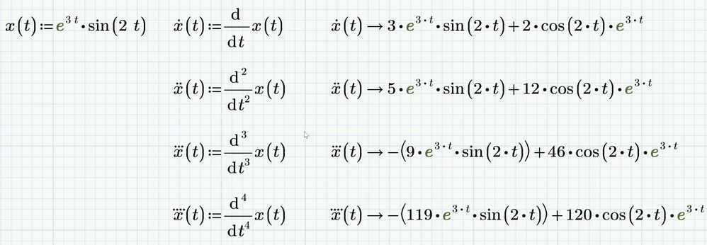

Now I said that Prime doesn't support dots on a symbol, but you will find letters with a dot on top in the character map.
To make a symbol of them is a bit tedious, but possible in Prime. So you can define ḟ (with a dot above it), and assign f' to it:
(First create a string, by typing a quote (") then insert your ḟ and then remove the quote.)
And that actually works, as you can see:

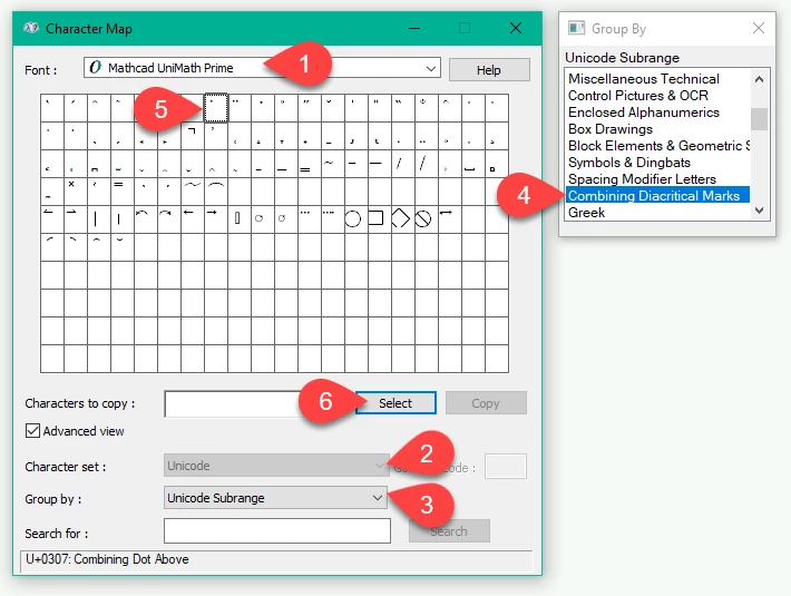

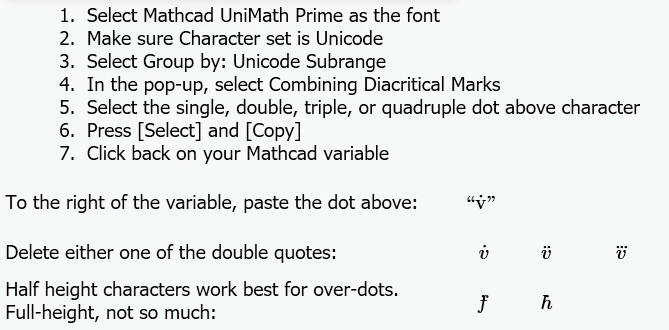

Actually, it's not that hard.
This works best if you are using the Mathcad UniMath Prime font as your default math font.
In addition to the over-dots, there are over-bars, carats, tildes, arrows (nice for vectors), and a number of other creative diacritical marks.  The nice think is that they can be place over any character, aforementioned character height issue withstanding.
JeffH1
May 10, 2022 1:04 AM UTC
Ok.  Since there are 8 steps to paste that mark on the variable, maybe it is that hard.
But it works and you only have to do it once and then copy and paste the variable wherever you want it.

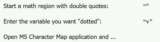

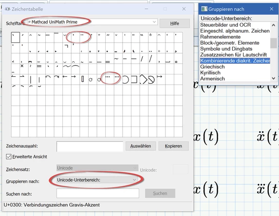

While Prime does not support dots on top of variables out of the box, you can create that kind of variable names using the diacritical marks taken from CharMap (included in Windows).
To create the variable name in Prime start by typing double quotes as if creating a string, type the variable name (in the example an "x" and then copy and paste the appropriate diacritical mark from the charmap window. The last step is to delete the double quotes and you have created a valid variable name.
For further actions its easier to copy and paste it rather than creating it from anew every time you'd like to use it.
Unfortunately I couldn't find a symbol for three dots in form of a triangle which is more common than the three or four dots in a row.
