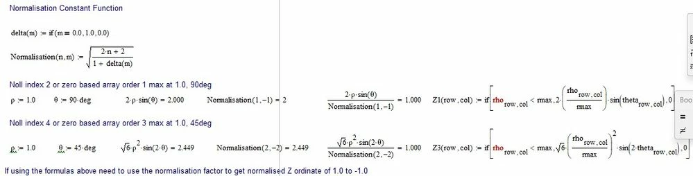

Have included a worksheet that shows the difference between:-
a) calculating by formulas Zj(rho,theta) that needs a Normalization constant, and
b) calculating using the direct polynomial definition Znm(rho,theta) that does not need the Normalization constant.
The Normalization worksheet shows the difference between a) and b)
I have made some alterations to the original file that stops recreation of the "file" matrix when you change the plot above.
Cheers
Terry

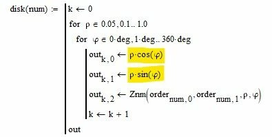

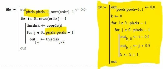

Taken a while to answer but the enclosed worksheet will help.
Cheers
Terry

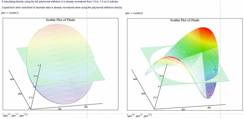

terryhendicott
Jul 17, 2025 5:49 PM UTC
Have made a correction and some additional information.  See items in yellow.
If you set the 3D plot to the following setting you get a plan view of disk in exact orientation as the Wikipedia disks.
Cheers
Terry

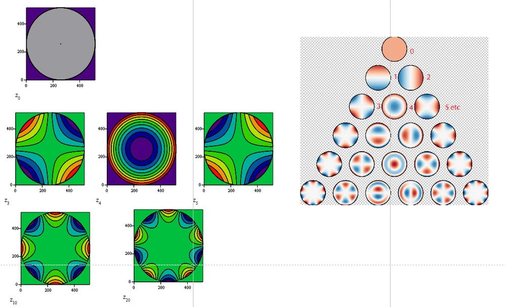

Jul 18, 2025 7:31 AM UTC
Not that I know what I'm doing here (unlike Terry), but this looked like it could be fun! So, perhaps the attached might be of some use.
I get the following images, which are similar to those on Wikipedia, though rotated:
