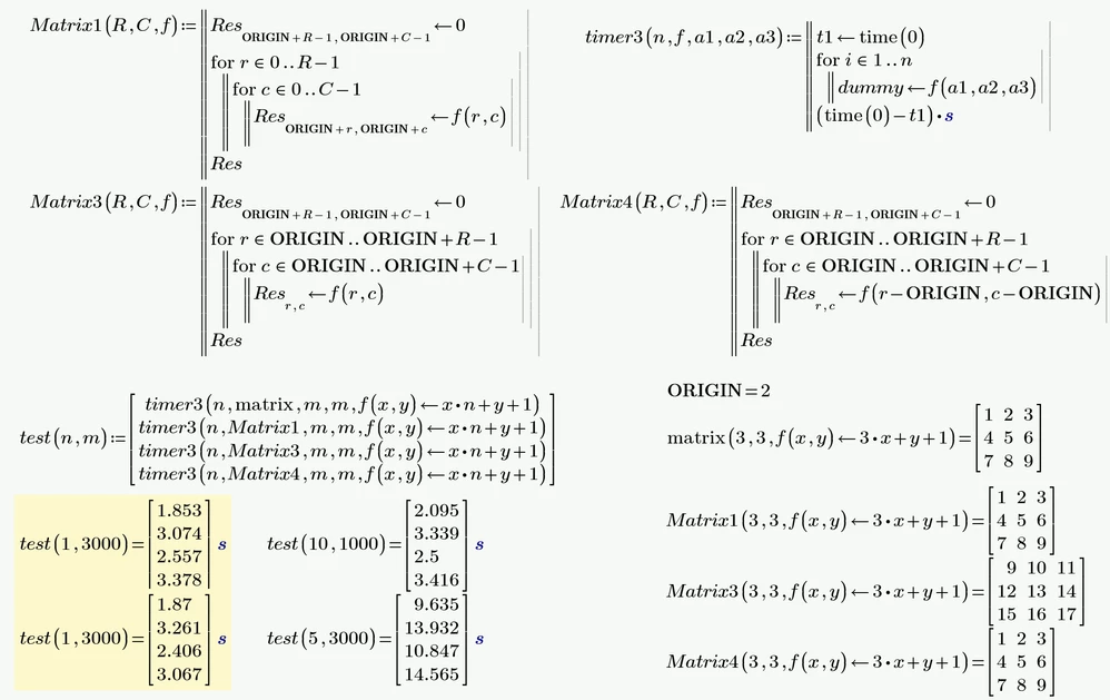

I couldn't resist: Similar samples of matrix generation. Defining the matrix in dual loop starting from top left does take longer than doing it from bottom right, but the difference is relatively small. I expected more. On the other hand, using matrix instead of dual loop was faster as I expected, but it still took about half as long as the dual loop. The loops fared rather well in my opinion. If there is any real calculation for the matrix values, the difference would likely be insignificant.
In this case multithreading worked a bit differently. The first two clocked relatively consistently a bit over 2 seconds each. The second may have still been slightly faster. The last two were interesting, though. The time in the first of them varied from about 0.6 to somewhat over 1s. The second was much faster. In some cases it was roughly the same as without multithreading and the max was maybe 0.7s. That kind of difference I didn't expect. Another thing I didn't expect is that on average every third run the latter two produced an error when using multithreading. There are obviously some bugs in the code.

To be fair you should also let the loop-programs call a function f rather than assigning a constant 1.
I also guess that the function should in some way use its arguments to avoid the effects of some sort of code optimization.
I made tests by defining user-written Matrix functions which mimic what the built-in matrix function does.
I guess if we create the whole matrix in front of the loops by assigning the last element any value, there should be no significant difference if we loop up or down.
My tests showed that
1) your machine is faster than mine 😉
2) timing is quite unreliable or there is a large random variation
3) the built-in matrix function is not that much faster than I thought!
Its surprising to see that even though the matrix is pre-created the Matrix2 function seems to be (very slightly) faster.
All timing was done with multithreading turned off as I won't trust any timing done with the time() function with multithreading on.
Nonetheless I tried with multithreading turned on and when I tried to recalculate the whole sheet, all four regions failed because of "overflow or infinite recursion". Letting them evaluate one after the other worked and the results were similar to the ones without multithreading:

Mar 6, 2024 1:39 PM UTC
Interesting how minor things effect calculation time significantly.
The adding (in Matrix 1) or subtracting (as in Matrix 4) of ORIGIN costs a lot of calculation time.
So Matrix3 is much close in calc time as the other two. Unfortunately Matrix3 is not exactly duplication what the built-in matrix() function does as can be seen in the example with ORIGIN set to 2.
